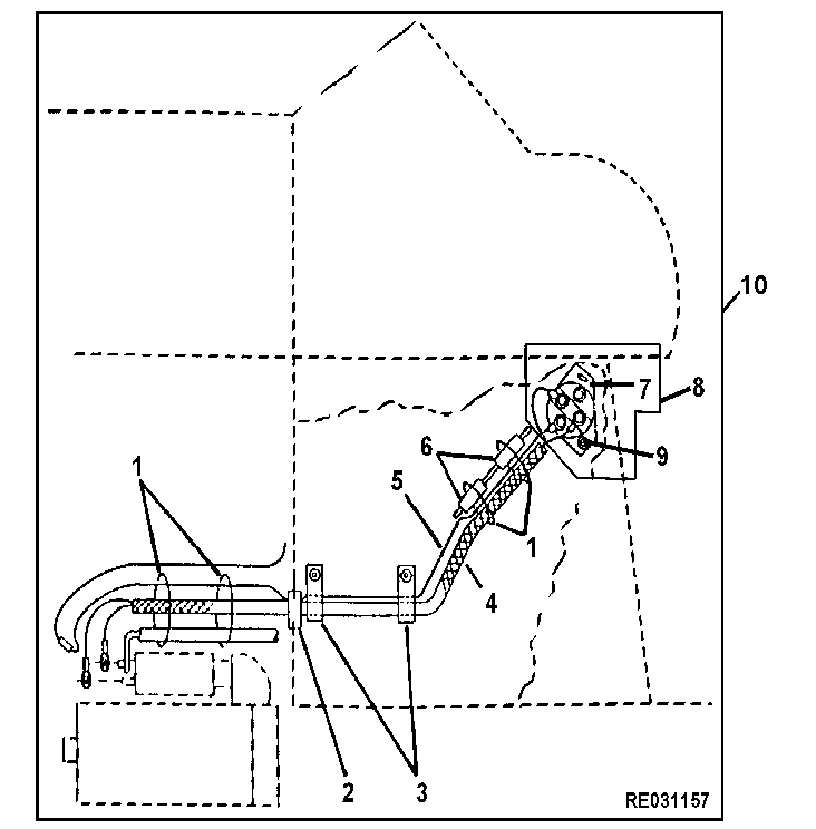

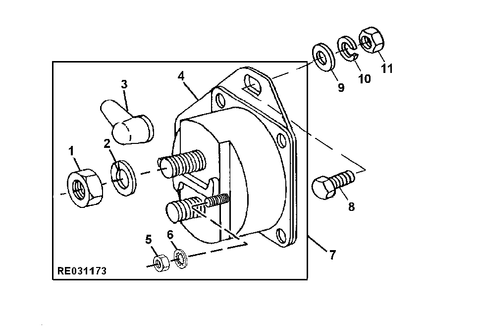

I would suggest to check amps on the starter solenoid exciter wire when ign switch is turned to start position. You could add a starter relay to give this exciter wire more amps. RE164448 Starter Relay - RELAY, STARTING ADD 25.37 USD
