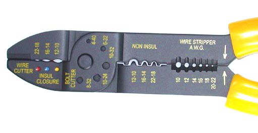

Get this crimper/stripper wire cutter tool: tool (any hardware store)
Get 1/4" tab quick-disconnect terminals: terminals (any hardware store)
Harbor Freight has the tool and terminals together for $10: 305 Piece Solderless Terminal Kit
