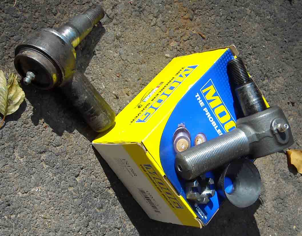

JD4110 strg ball n sockets worn out. Need some mod links

Does anyone know the Napa tie rod ends/brands I might ask for? The tie rod link holes are 13.7mm at bottom & 10.45mm at the top approx. The other thing too...is there a choice of having the new t-rod welded to link/bar OR welding a "threaded sleeve" to link/bar for future replacement and or adjustment:)?

I got this for my JD4300 at a Napa. Moog.
They have a large book that shows Moog sizes.
I did have to drill and tap it, however.
What's the part number on that? and..so you did both sides of the bar-& you drilled & tapped the oem bar across the front & made it adjustable? Also, I want to do the one at the end of the p/s ram-rod....
