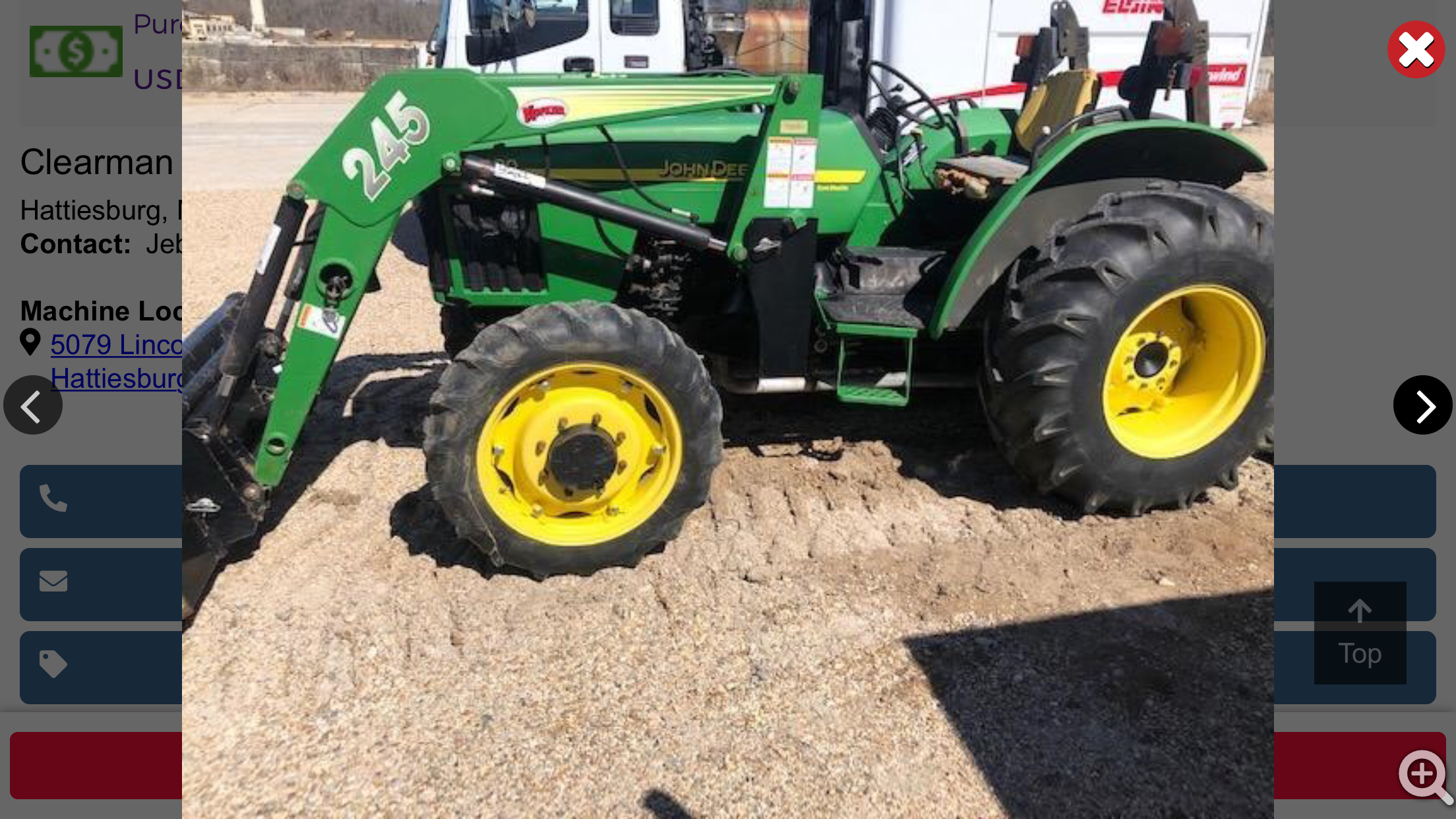

Hi guys, it’s been a while for me. I sold my 3320 and I’ve purchased a used 5420 model (1,200 hrs, no cab, 9x3 transmission) I’m excited for the upgrade. My question is this, I had the tech manual for my old tractor and it really came in handy (4 inches thick). I’m looking for the same one but for my 5420. As I look on the websites I see about 20 different manuals. I’m hoping for 1 all inclusive tech manual. Any help is appreciated!
