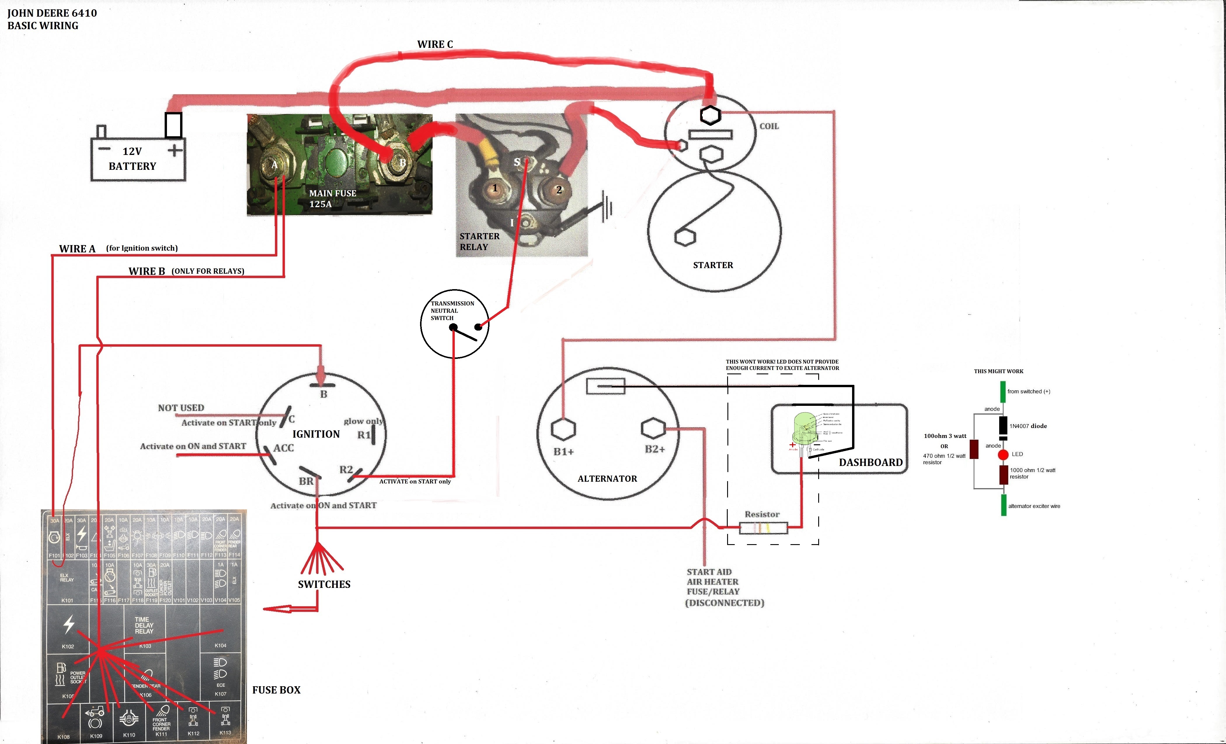

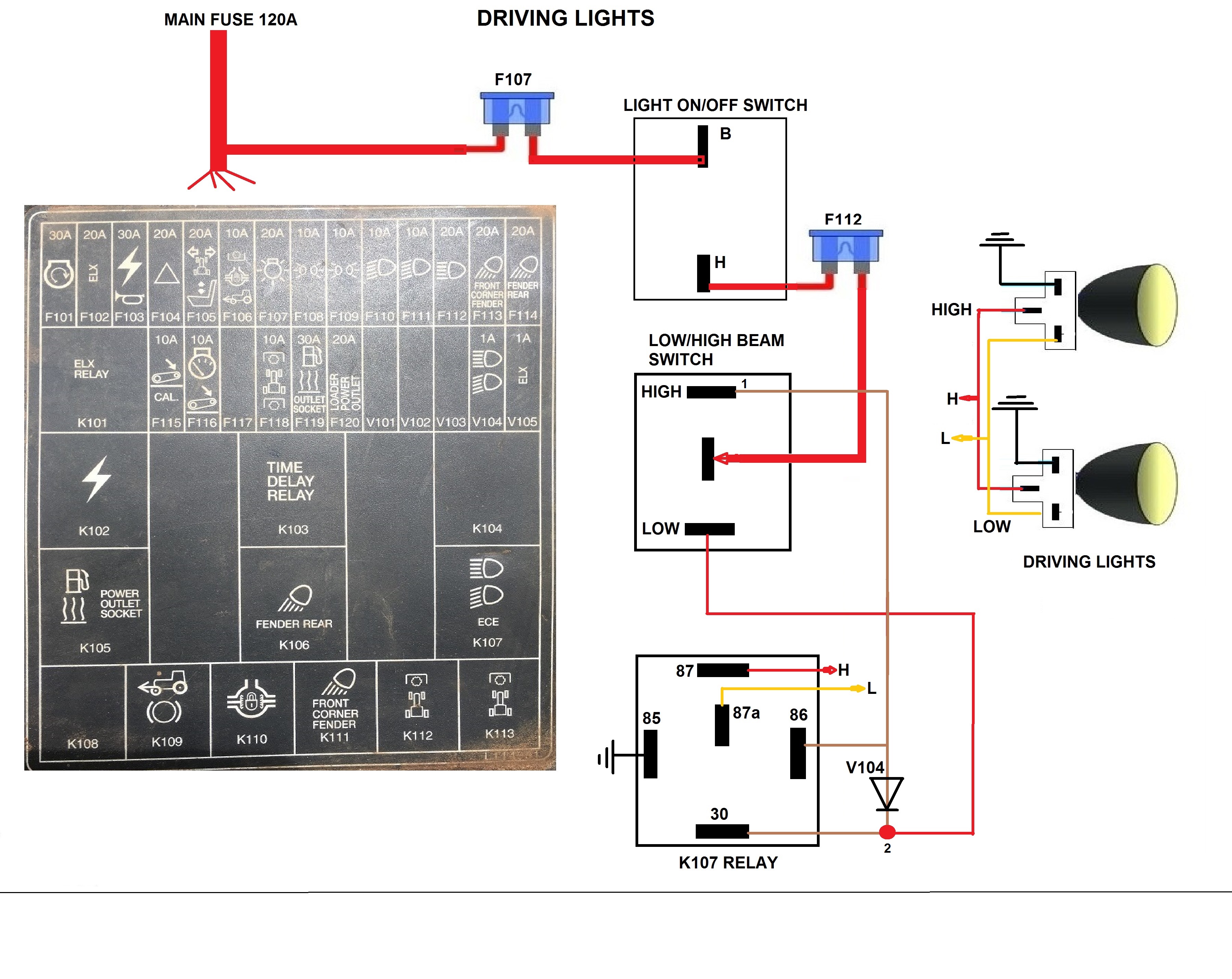

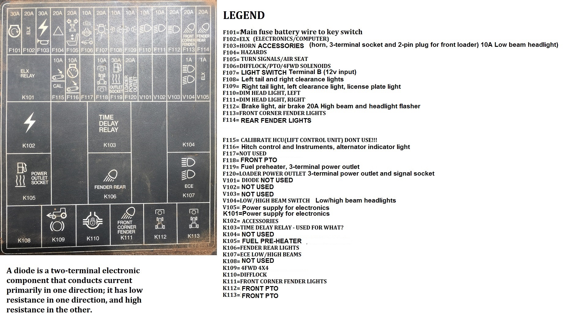

Can you guys review my 2 drawings.
I need help with diode V104 and fuses F110 and F111.
How about a schematic? that will be fantastic!

For alternator exciter wire just use 2-3 watt 12 volt bulb incandescent bulb.... Much simpler then the LEDS, diodes and resistors....
Why not put direct power from headlight switch to 30 of relay ... Put power from dimmer switch (high) to 86 on relay to operate and it would put power out on 87 and could power high beams, put low beams on 87A and with relay not operated (no power on 86) low beam path is through 30 and 87A, 85 remains ground for relay...
This would assume (bad word) you want relay operated for high beams...
Dale

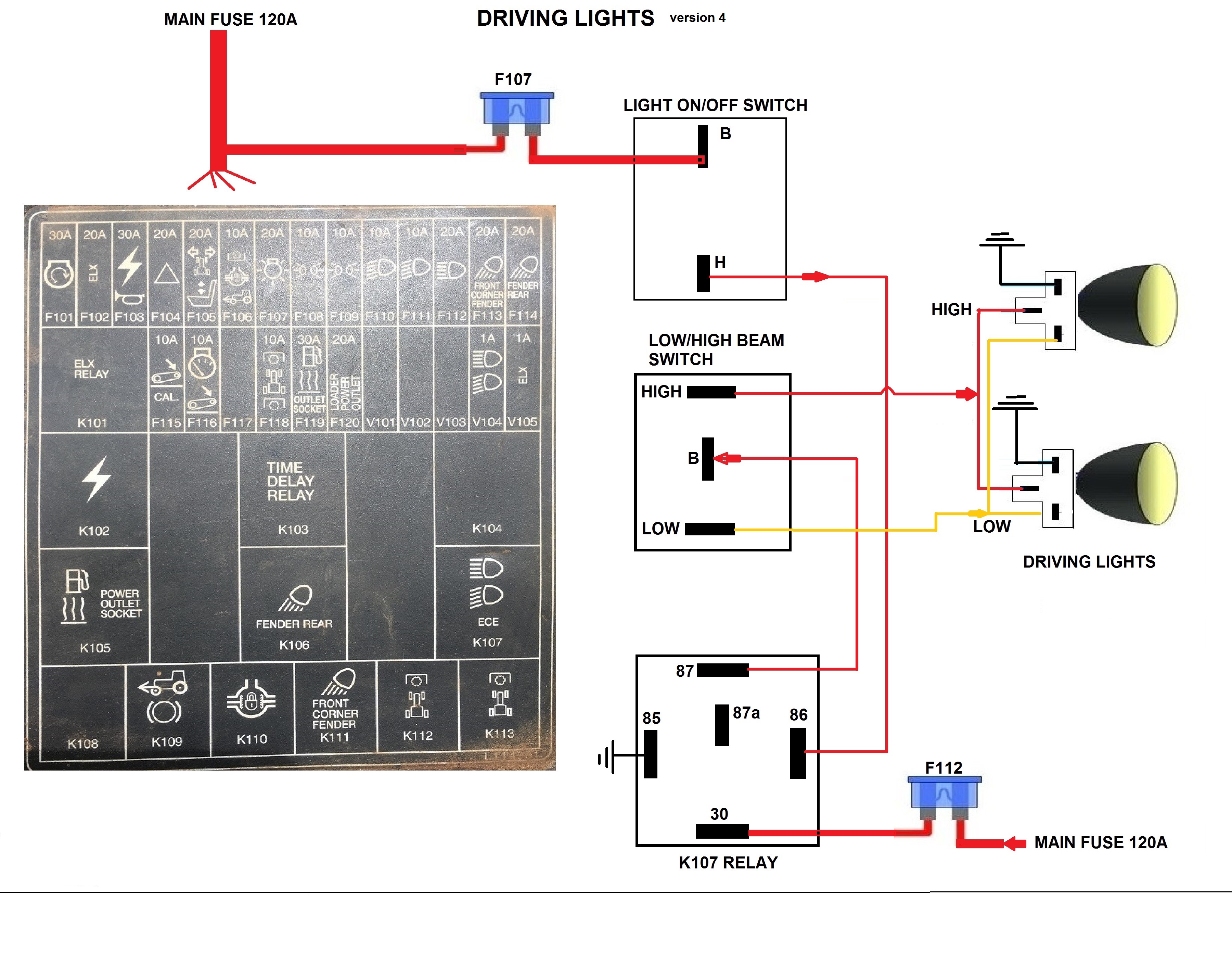

I did drop the led.
I have been told that the low/hi beams are powered directly from lo/hi rocker switch.
I can also see from what is left in fuse box, is that terminal 87a was not used.
Thus, I have made diagram version4.
Still dont know about fuses F110,111.

I have spend 3 hours on Google trying to find Schematic.
This the domain of JD dealers and mechanics and they DONT want to share.
members like JD110 have got it,but alas no response.
