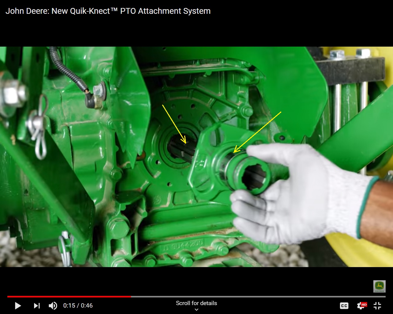

I guess I missed what keeps 1st piece of Quik-Knect on tractor pto shaft. IMHO the way the rear gauge wheel on mower is flipping from side to side the 3 pt centerlink needs lengthening a little.

Wondered the same thing.. looks like it must snap onto the PTO shaft..
Hope more info comes forth...
Would the chrome band possibly lock onto the milled groove on the PTO shaft.. yellow arrows ??

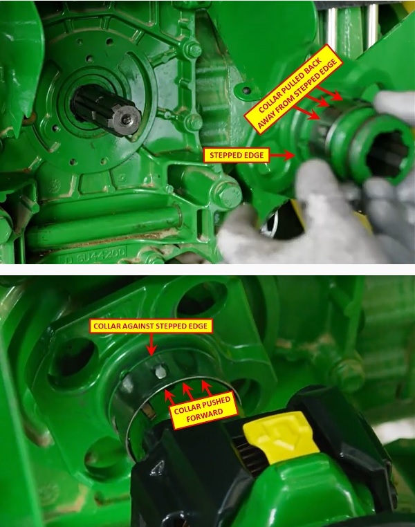

Just found an answer maybe, in the link
Shows where the collar on the 1st piece slides back and then forward to lock that first piece onto the PTO stub.
Discussion of this Quik Knect was last fall already.. going to check with dealer today.. prolly the 2nd part is on the expensive side needed for each PTO shaft..
