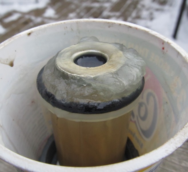

If you expect to be able to run straight #2 with no additive in the coldest of weather with just the addition of a fuel filter heater you are going to be greatly disappointed. Your fuel will get in the tank and look similar to MarkF48's picture and will never flow to the filter heater.
My neighbor filled his 500 gallon storage tank with straight #2 fuel a few years ago. Couldn't pump it out of the tank until the temps rose back up into the high teens. Then he added Power Service White Bottle to the tank and used the pump to circulate it. Then was able to use the tank the rest of the Winter.

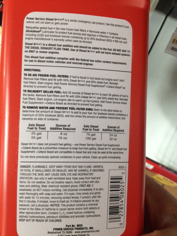

Alright. Hopefully the fuel filter heater will keep the tractor running with a borderline tank of #2 diesel at temps above 0F?
/ Jelled Fuel #22
I'd give that a 50/50 chance. You are expecting straight #2 to not gel in the tank at 0F. Iffy at best. But it's your tractor.
