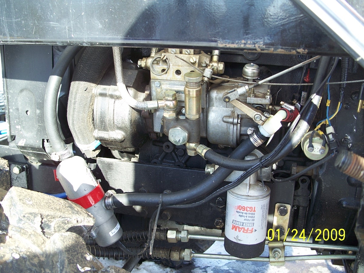

My secret weapon for cold starts. 1000 Watt tank heater. Depending on the outside temp it will heat the head to summer temps in less than an hour.
