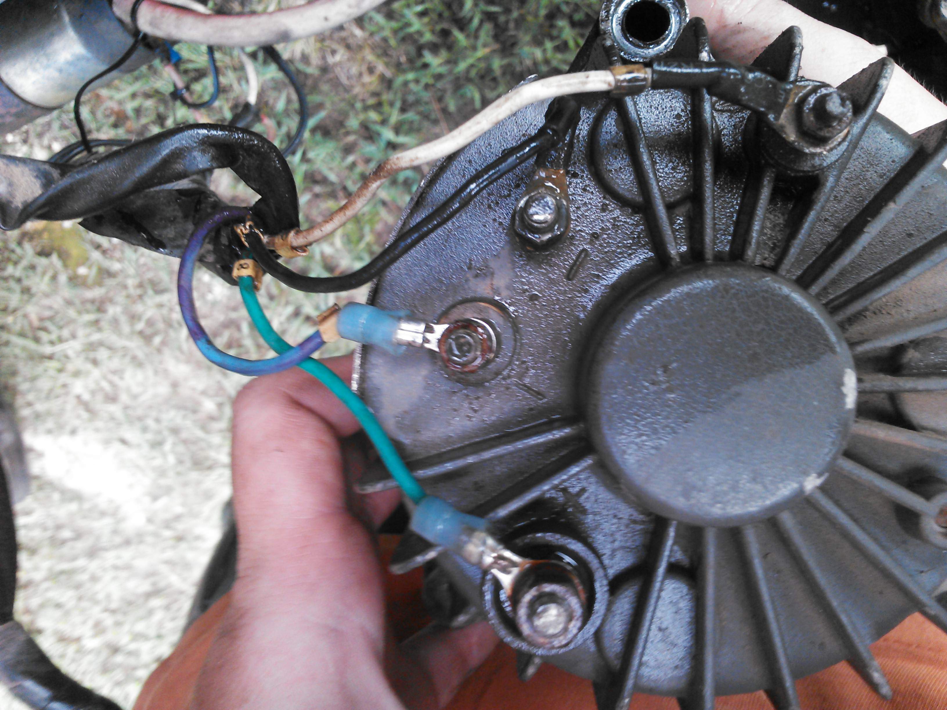

need wiring diagram for 2006 jinma 204 alternator
If you can see this picture I changed my alternator out with a one wire GM alternator.
Hooked Green and the purple wire to the plus on alternator and ran a #10 from the plus on alternator to the starter post from battery.
Tied the black wire to the ground.
I still have to get the gauge working but the wiring seams to be OK for charging and running.
I believe I have tied 2 positives to gauge by doing this. Green from gauge comes from fuse box and purple goes through plug and is yellow at gauge. That same purple wire ties back to switch and tractor will not crank without it tied to positive.
