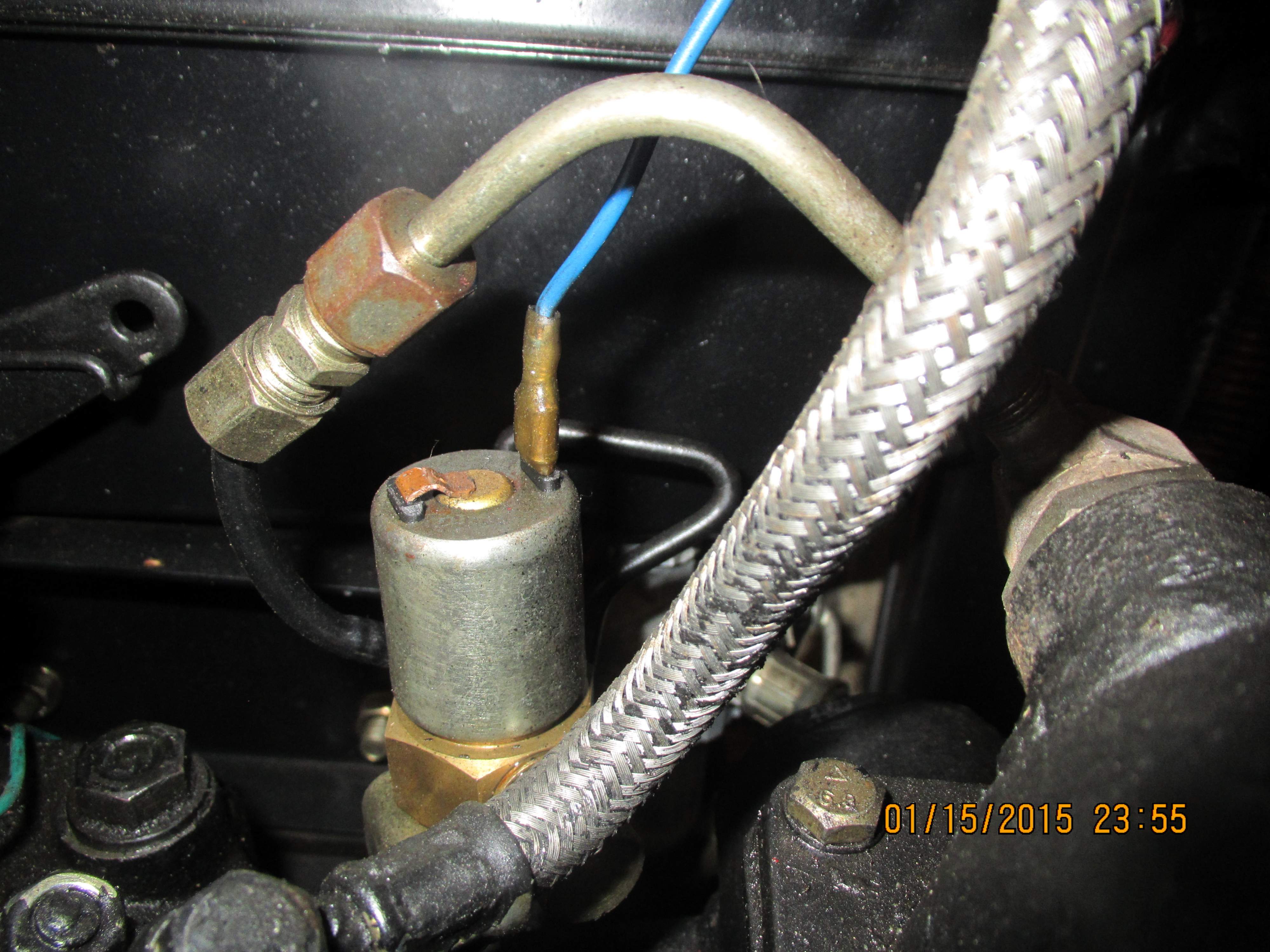

The thermostart is OEM on my tractor, I buy it brand new, and it have glow plug to, all of those are working just fine. My problem is that no fuel is going to the thermostart because the solenoid valve on the line going to the termostart is not working and I cant find a part number for it, I look in my parts manual but i find nothing and the JINMA dealer cant see it in is book.
If somebody here have any info about how or were to get that part it will help me. Thanks

Art, can you post a picture of your solenoid valve please?

sel.jpgsel.jpgThere a picture of the selenoid valve.

The funny thing is that I cant find any information about thermostart on JINMA tractor on the net, I wonder why????

I will instale new wiring and relay for the glow plug for sure and i am going to make the thermostart work as well. I see that the yanmar tractor have thermostart but there system have no selenoid valve, they have an little metal ball inside the thermostart that it come loose with the heat and let the fuel flow, I think I will retrofite my tractor with that model. I am going to dig more into that and let you know the result. Thanks
