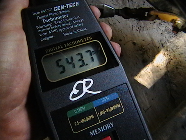

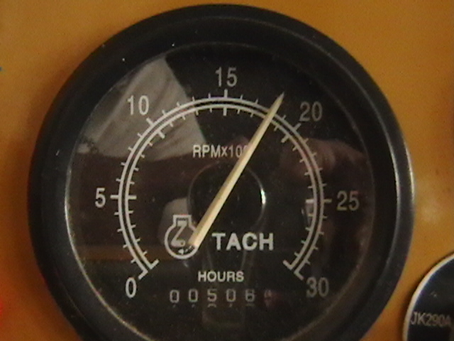

On my machine 1850 r/m gives 540 r/m at the PTO shaft. Your tachometer may have some kind of mark in that area.

Correction: More like 1,790 - 1,800 r/m. Just found the pics.

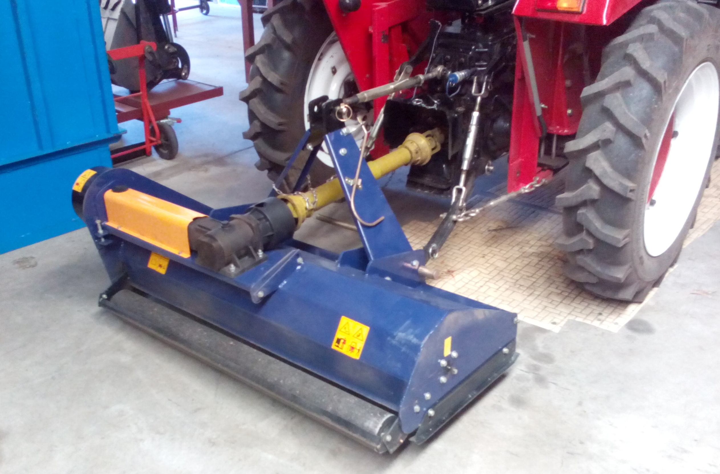

I'm in Mount Helena which is about an hour East of Perth. I'm only on 5 acres so the little 254 suits quite well for what I need to do.
It's one of those No Name Chinese flails but looks very similar to a Hayes product FLAIL MOWER HPHD13 - Hayes Products - Tractor Attachments and Implements
I guess when I said going really slow I should have said really really very slow, I'm talking scraping between trees with the bucket removed to give me a bit more of a tighter turning circle.
Here's a quick pic. It's sitting up off the ground on it's support leg here as I was about to take it off.
Don't have much salt bush here but it seems to chew through just about anything if you go slow enough.

Looks like it would do the job though. I just ordered that exact Hayes mower the other day, couple of weeks until it arrives.
