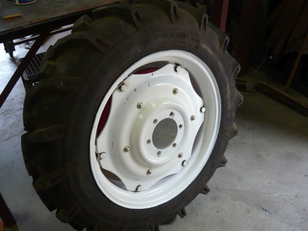

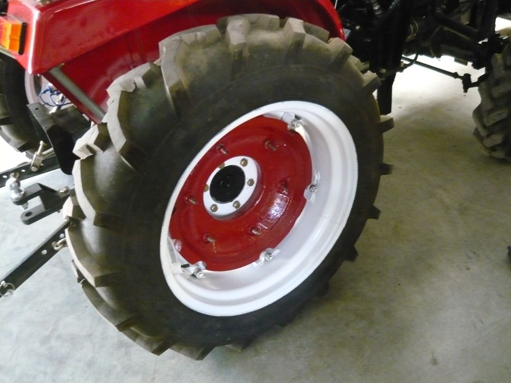

Yes, the wheels have been set to their widest stance by flipping the inner discs of the rear wheels. I highly recommend doing this as it dramatically improves the stability. I also swapped the wheel weights to the other side of the inner discs so they still end up on the outside of the wheels. I painted the weights as what was the inner unpainted side is now outwards.
Some people swap the front wheels over to get a wider stance on the front too but I reckon that is a big mistake as there is evidence it leads to front hub breakage and because the front axle has a central swivel point it doesn't really improve stability much anyway.
This is what the wheels look like after the change

I'll have to look into widening the rear wheels after harvest. My first thought is that it's going to put more stress on the rear wheel bearings, but everythings a trade-off.
