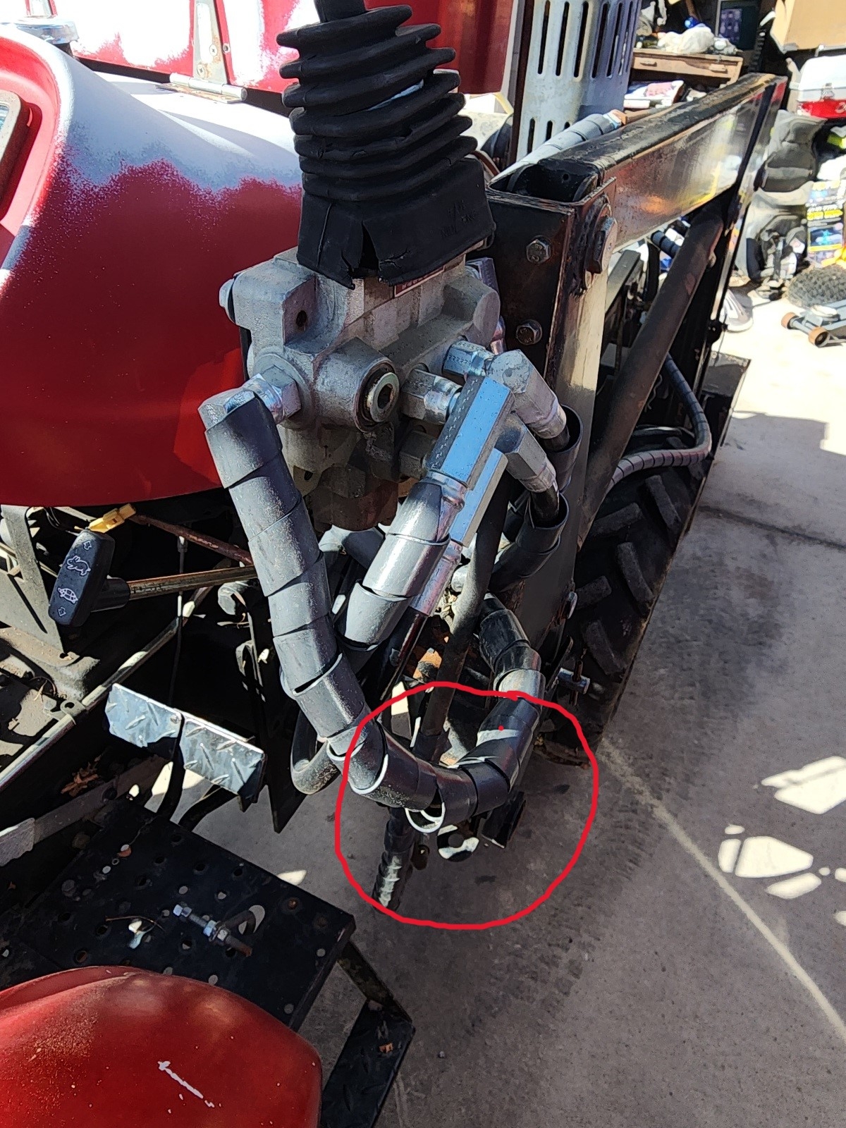

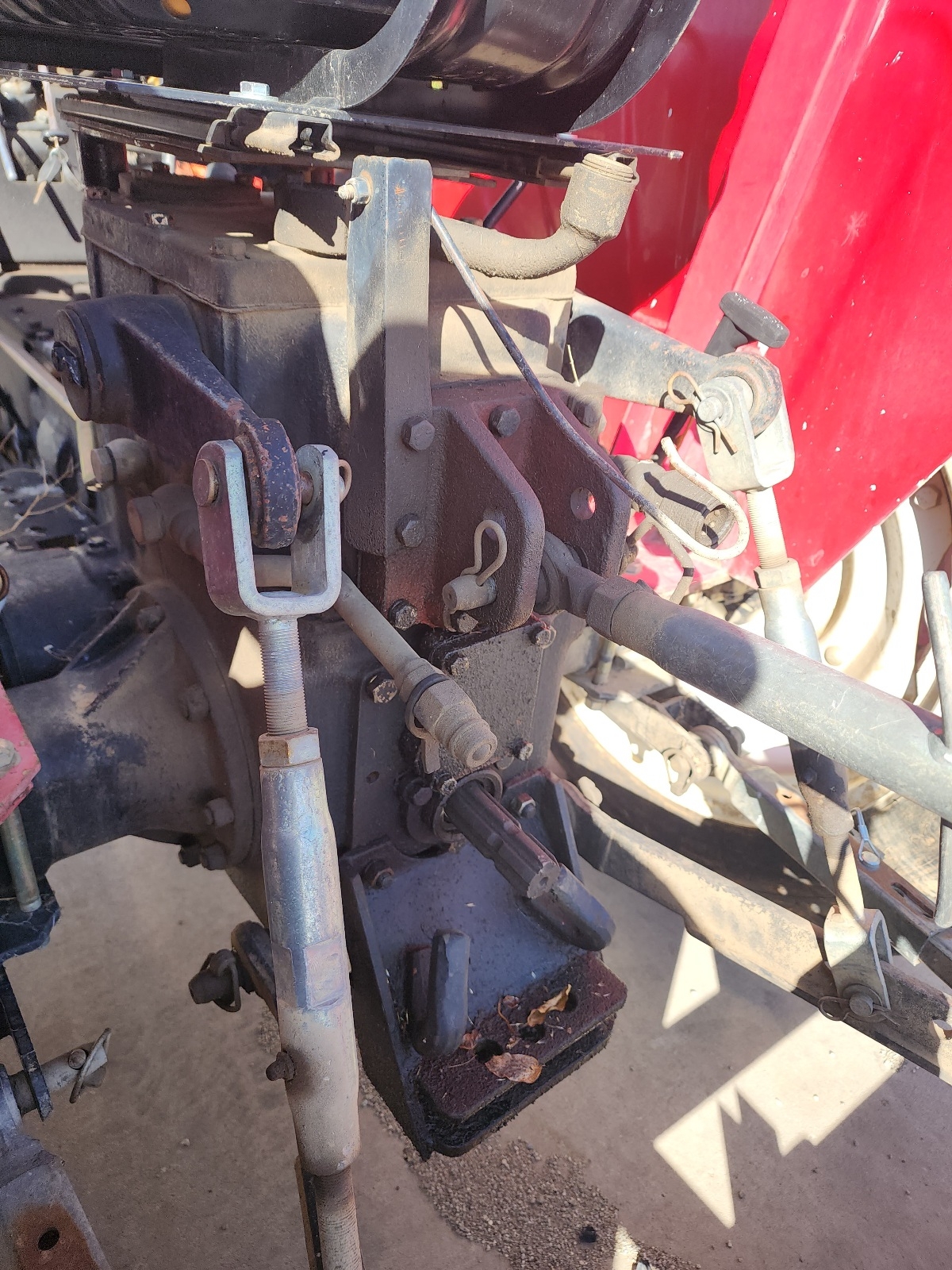

As the title says, we have a Jinma 254 tractor that has a hydraulic issue. We are the 2nd owners of the tractor and it has a few issues related to the hydraulics, the biggest is the previous owner bypassed the hard lines for the backhoe attachment and instead has split the line on the front end loader to power the hoe attachment. The hard lines that run back to the 3 point hitch (where the hoe would normally hook up to) are still there but are not being used. The rear 3 point hitch is extremely slow to activate when first getting going. The system seems to be leaking the hydraulic fluid out the rear of the tractor under the seat (seepage, I'll try to get a picture of what I'm talking about in the next few days). When fluid levels are full (after cycling the front end loader and rear 3 point hitch to ensure that there is no air in the system) it seems to work ok for a while.
Whew, long winded backstory completed...now for the questions.
1. There a way to see if something is blocking the lines that are supposed to feed the rear hydraulic system (backhoe or whatever)?
2. Would a internal (ram) seal for the 3 point attachment allow leak down and seepage of hydraulic fluid?
3. If the system is torn down, can the hard lines for the rear attachments be cleaned/inspected (kinda goes along with #1)?
