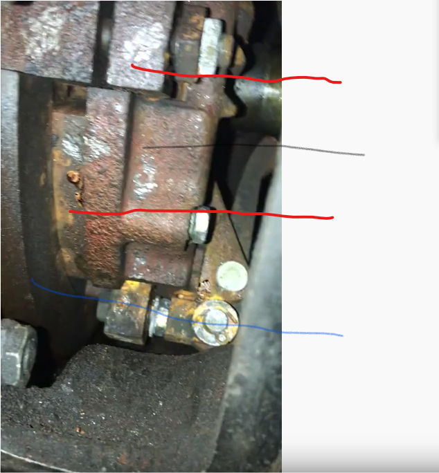

Updates:
The tractor is an AG-BOSS 284. It looks like it was transferred to the original dealer in October 2004 - I have some of the original transfer paperwork. I am the third owner.
I've posted a video that may help: AG BOSS 284 Clutch Not Disengaging - YouTube
This shows what I am seeing thru the access hole while depressing the clutch pedal. I am not sure what the clutch plate is. There is movement of the linkage, however I am not seeing any plate moving. Any clarification on what I'm seeing would be helpful.

   / Jinma 284 Clutch Problems #10
Hopefully the attached picture goes through. The top red line is the main clutch pressure plate. The black line is the clutch cover which is not supposed to move, the bottom red line is the main clutch disc and the bottom blue line is the fixed pressure plate. You can see these items in the clutch drawing in the manual.
It would appear your throw out bearing is moving properly and far enough. You can see the release lever (fingers) pulling the main plate away from the flywheel end. This is proper and it appears to be moving far enough that it should release the disc. Looking at the disc my guess is that there is a little rust sticking the disc to the fixed pressure plate.
Hopefully it is not too bad and you can break it loose either by rocking the rear wheel with the clutch pedal tied forward or perhaps towing it with another vehicle.
Don't try hitting or prying on the disc and also don't use any type of rust penetrate or solvent. You might try (with the clutch pedal tied down) tapping on the edge of the fixed pressure plate. You may have to manually turn the engine over slowly and tap all the way around.

#11
Success!
The picture came thru fine. So - after studying this picture and the cutaway view in the manual (for a long time), I determined that in fact the clutch disc was stuck. I tried jacking the left rear wheel and popping it free by rotating the wheel while in gear and pedal tied down. No luck there. My next move was to cut a wood dowel to fit in against the clutch disc (main clutch driven plate in the cutaway view). There is a slight groove in the disc that allowed me to tap away from the pressure plate. Doing this around the disc (manually rotating the engine) eventually popped it loose!!!
@piper184 - you have been exceptionally helpful with the details - thanks!
As usual, the forum members have guided me off the ledge (separating the tractor is not in the cards for now). I appreciate the help.
