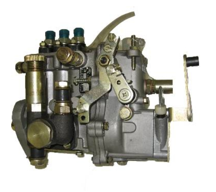

Sorry to dig up an old post but Im still researching before I call a pump guy in and thought I’d try what was mentioned in this thread. I’m hoping mine is just a stuck control rack as that is the only thing I haven’t checked yet.
Could someone please show me where the inspection plate is please? I have the Jinma 254. Thanks!
   / Jinma 284 fuel system questions #16
No inspection plate on that pump Koosh..
I havent seen that pump on my work bench so I dont know if theres a "cap" on the front of the pump..??
If there is 1, it'll be next to the inlet banjo bolt.. on the front of the pump..
U might be able to get to the control rack thru it..??
