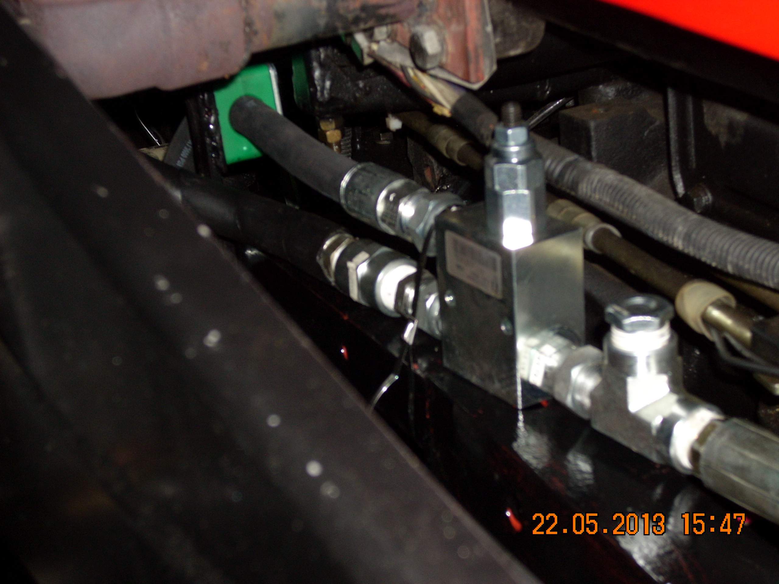

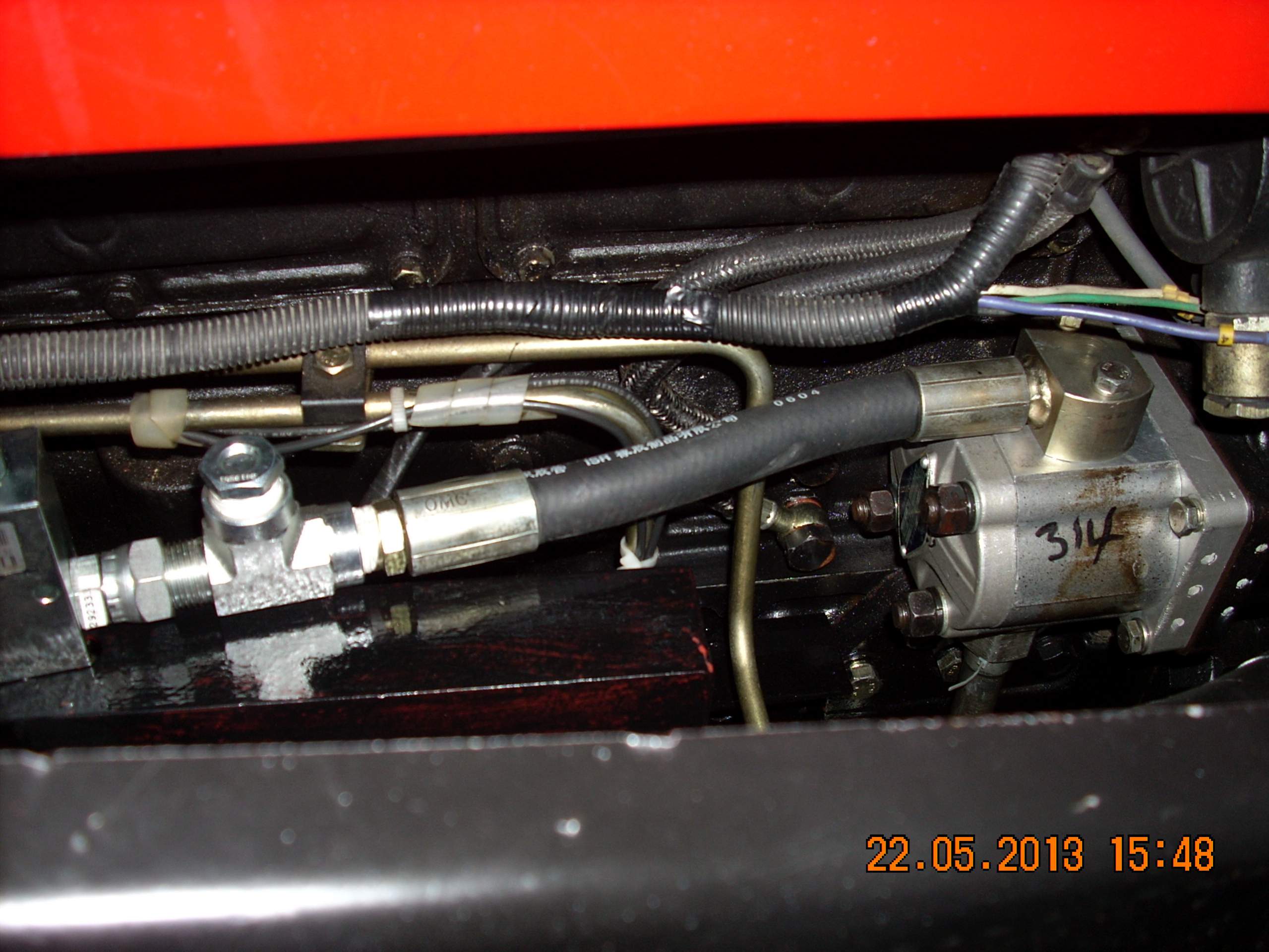

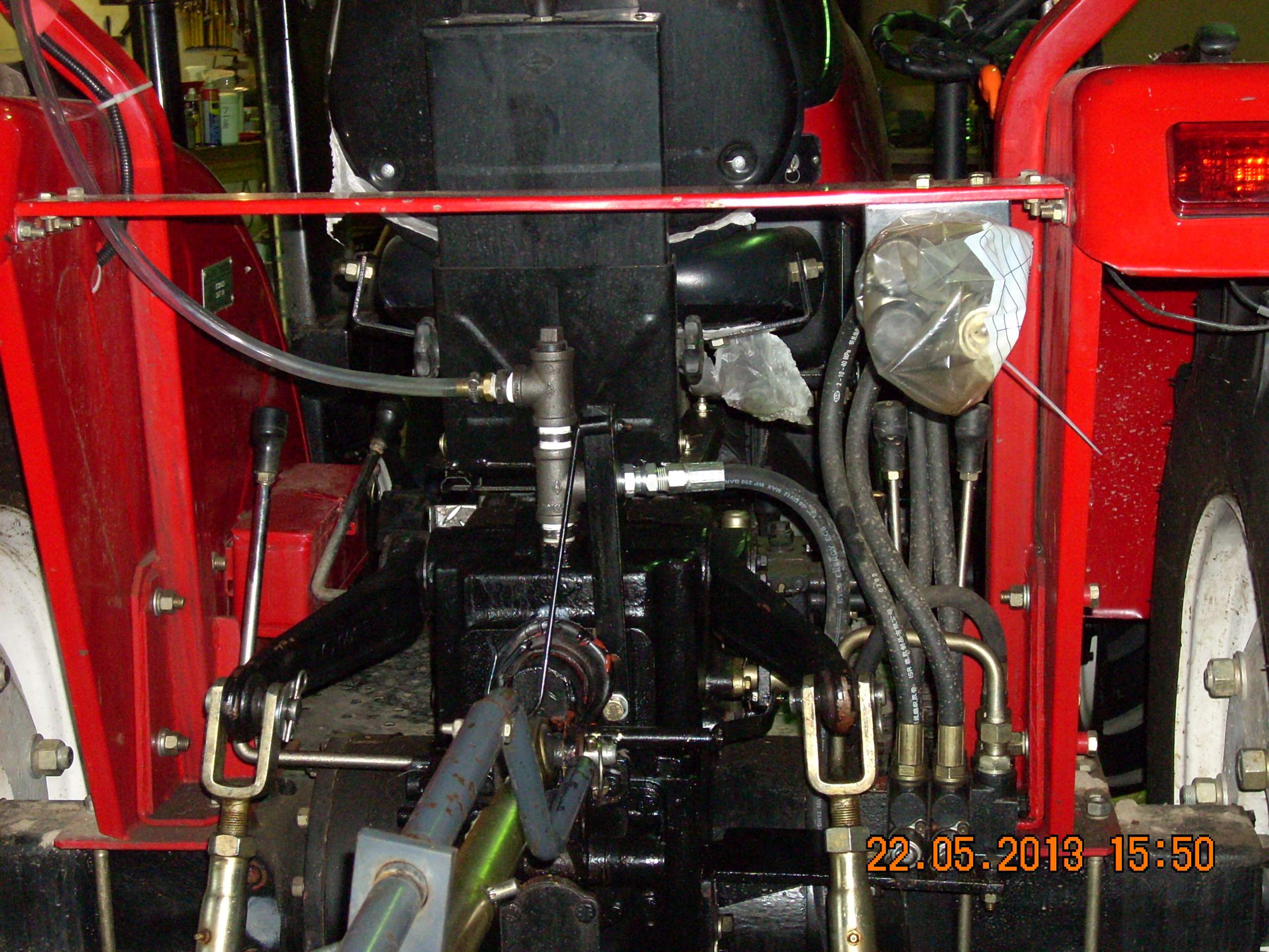

I blew a new pump because of dead heading - suspect that my problem was a faulty QD.
Have attached some pics of what I did to add an external relief valve. This might help with your situation. The relief valve oil is sent back to the vent on the hydraulic tank. So far, no problems with the installation.

I thought the Quick Disconnects were faulty, so I removed the inner parts (ball, spring etc.) and reused the outside part.
The relief valve I set at 1900 psi. The relief valve was rated at 10gall/min if my memory serves - more than enough for that application. Remember, the relief valve stays open only when the pressure is 1900 psi - lower than that the valve remains closed.So for 99.9% of the time you won't need it - but when you do it is there to relieve the pressure.
You should be able to purchase a suitable relief valve from almost any hydraulic shop.
All the fittings I used were 1/2NPT and where I tapped into the hydraulic tank vent it is 3/4 NPT. I used a 3/4 - 1/2 reducing bushing there. I used the 1/2" hose as it was available already made up and at a decent price. From the relief valve back (I went under the floor plates and around the rear axle) to the tank vent I used an 8ft long ready made hose.
I made a couple of angle iron brackets to support the relief valve and the hydraulic hose.
I have had no problems now since installing the relief valve - it is needed believe me as what Jinma use is not sufficient.
HTH
