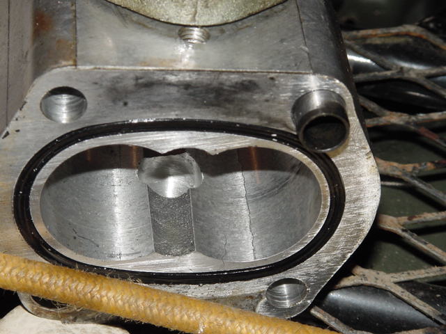

Like Ronma said, don't use two different QD's. They may lock together but they also may restrict the flow. I had Koyker to Jinma for my loader way beck and it cracked my pump.
