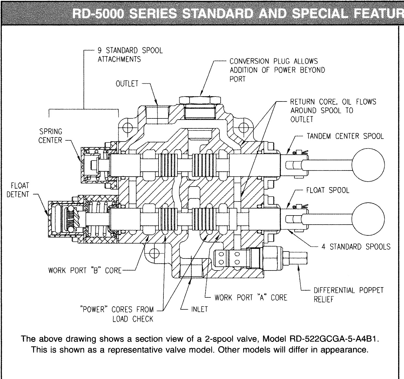

Zman,
You didn't respond to my question. Were the lines that were not connected the In and Out lines for the FEL control valve that are mentioned in quicksandfarmer's note?
When you removed the pump, was the driveshaft damaged?
My suggestions:
1. Check the centering springs that Jim Doxford mentions in his note.
2. Install a pressure gauge, at least temporarily, to see whether you are getting enough pressure to actually do anything with the FEL.
Below is a drawing of a Prince controller that may help you. The centering springs are on the left side.

Thank you for the Drawing Erj, looking at the drawing the valve controller does not look that complex.
