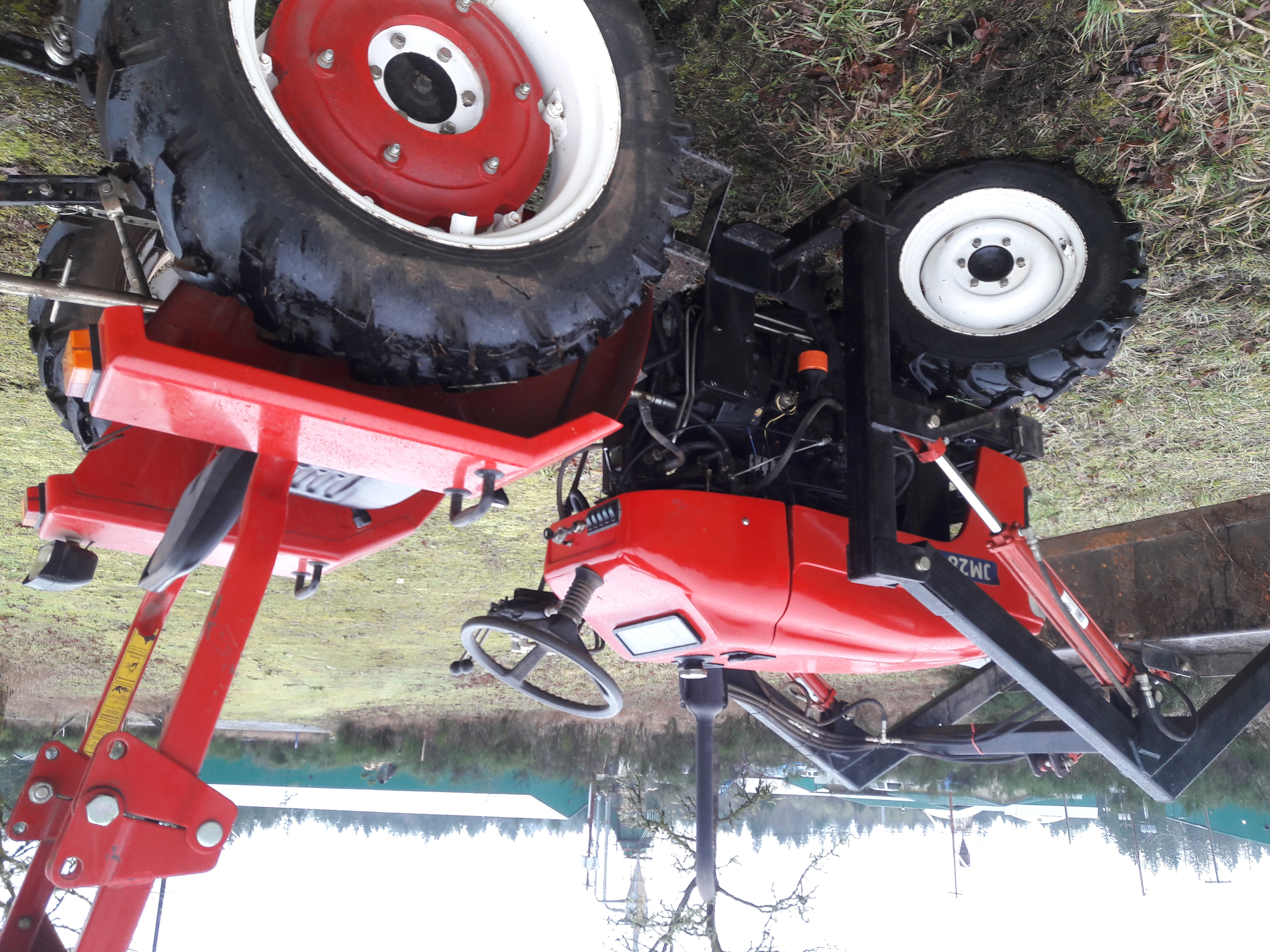

You will get far better advice by posting pictures of both ends of the pto shaft, the digger and your tractor.
Since you run a bush hog, there should be not internal pto problems.
Shear bolt will likely be cause which is where seeing pictures will help...
Is there any manufacturer and model info on the digger?

the PHD is a Greenline EM5000, and the tractor is a Jinma 284LE. I've posted pics of the tractor and the PHD....I hope they come through
Tractor.jpghttp://www.tractorbynet.com/forums/images/attach/jpg.gif

#16
Thanks to everybody for the suggestions. I've got it worked out....and I'm embarrassed to say it was a giant "senior moment" . I completely forgot about the "high-off-low"
speed lever and was only using the "engage - disengage" PTO lever.
