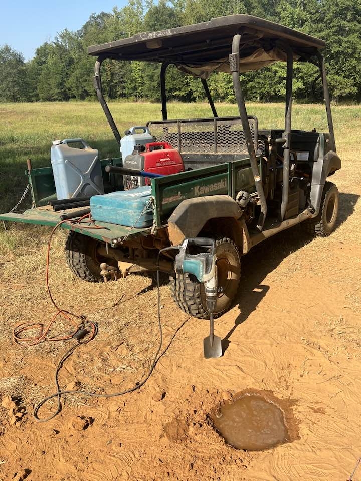

In August and September, my ground becomes like concrete. I still find spots where I just cant drill into the clay with the auger, so I use my SDS Max Rotary Hammer with a Spade Bit to break through the ground and dig down about six inches. Then I fill the hole with water and let it soak into the ground. I add water to the hole during the week, and by the next weekend, I can drill it easily.

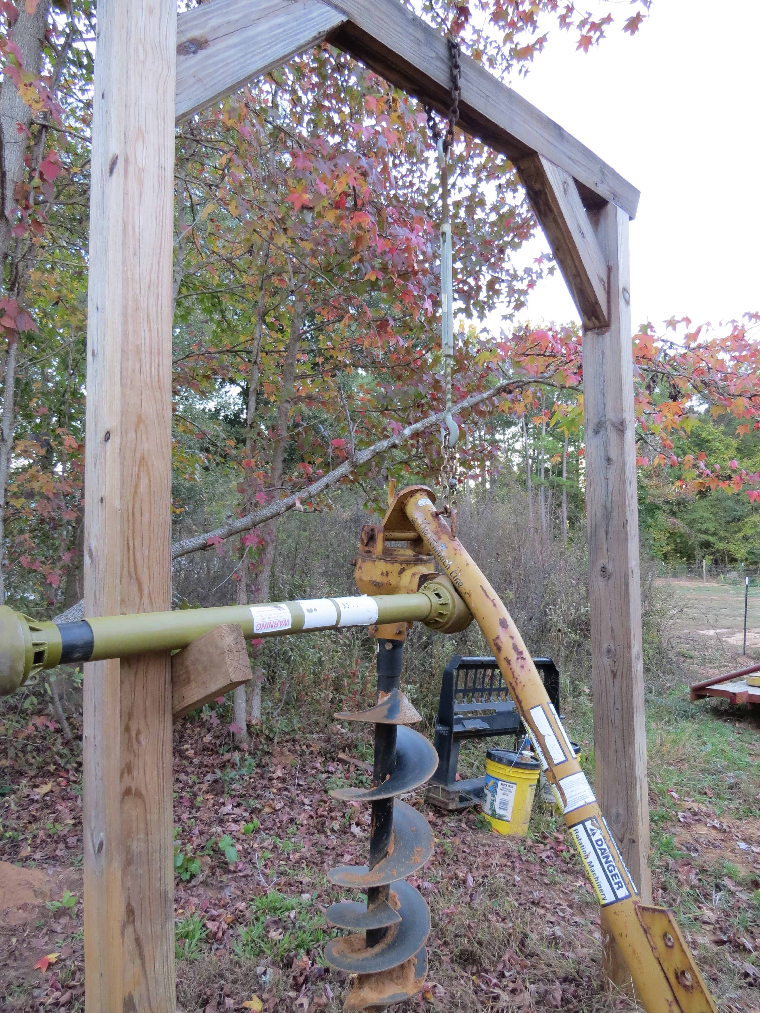

When not in use, I hang it from a wooden frame. This makes it easy to connect it. But it also keeps it off of the ground, which I think is important.

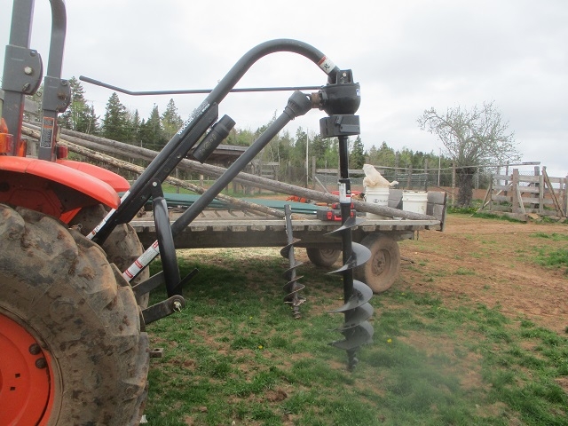

Will a 3 point post hole auger allow you to drill deep enough to get below frost table? Northern New England I suspect that would be minimum of 4 ft possibly more.
They will with an extension. The regular augers only go down about 42", even though they call them "48 inch" I can get almost 5 feet with this.
