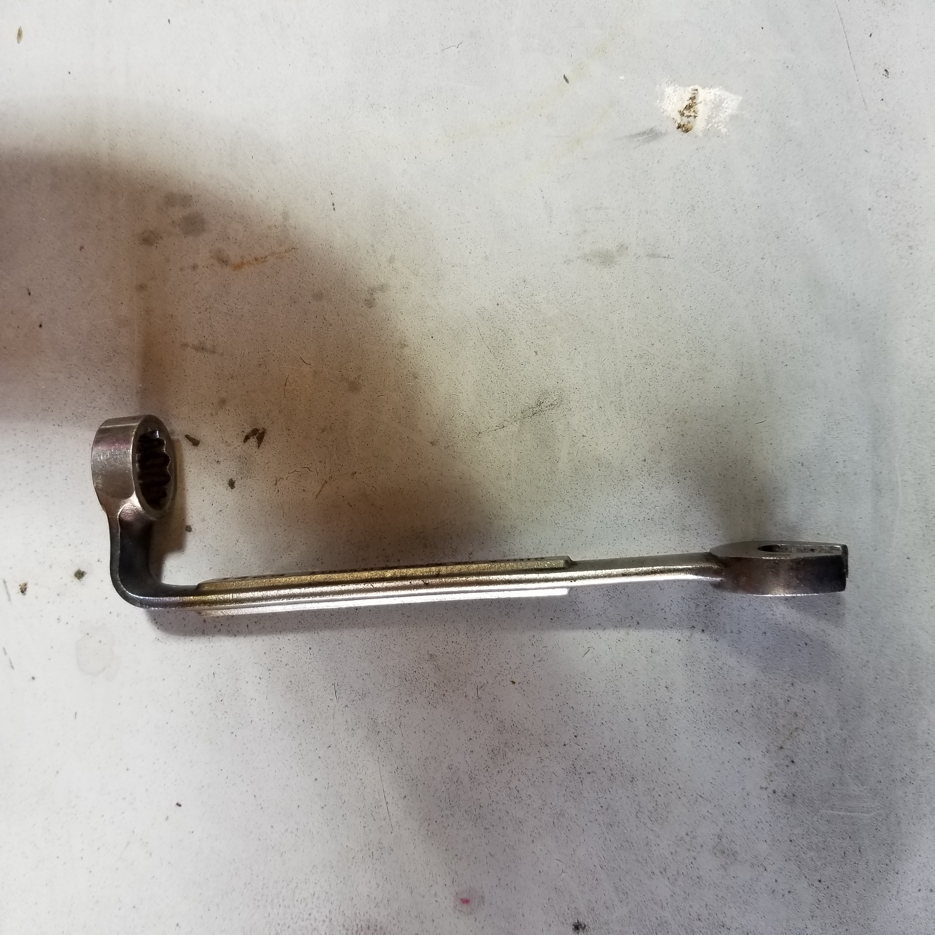

This is an old thread. but I hope someone can help. After fighting with that bolt, I - with Tommy's help - made a wrench
and got the bolt out. Now there is nothing holding the pump in, but I cannot budge it! According to the parts diagram,
it should pull down from the hole in the block. I am totally stuck. Maybe it is a "force fit" and needs the 500 pound
gorilla to pull it out??? Any help would be GREATLY appreciated!
PS here is a pix of Tommy's wrench that he sent me. My cheep (fat) wrench also had to have some metal ground
off the box to clear area around the bolt head. Hope this helps if WrenchMods.jpg you find yourself in the same fix......
cheers,

When I replaced all the lower end bearings in my engine I dont recall having an issue with removing the oil pump. I believe there is a bolt on the inside that has to come out.
off the box to clear area around the bolt head. Hope this helps ifView attachment 608819 you find yourself in the same fix......
cheers,
johndView attachment 608819
