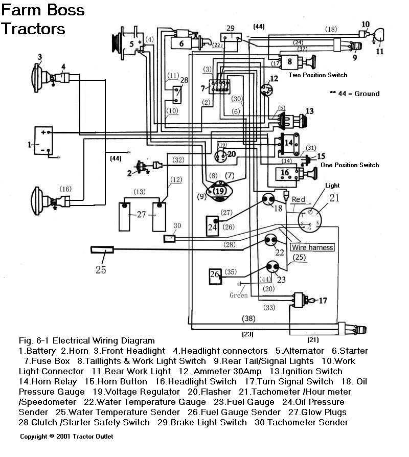

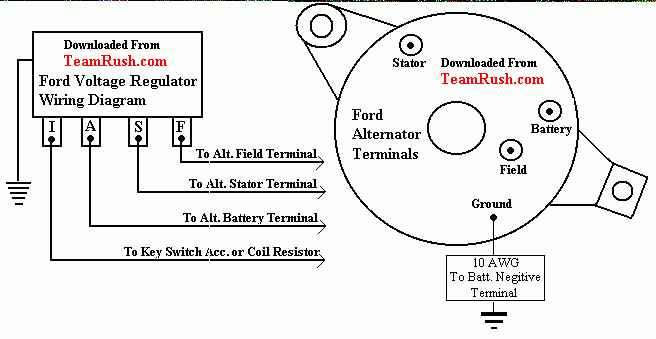

Perhaps these diagrams will help. On the wiring diagram:
#5 is the alternator,
#19 is the regulator,
#12 is the ammeter,
#13 is the keyswitch,
#7 is the fuse box
the numbers in () correspond with little ID tags on the wires.
//greg//

Wow! That is one valuable schematic diagram. Where did you get that? It is 10x better than the one in the tractor manual. The wire numbers help a lot.
Thank you! This will help with troubleshooting.
