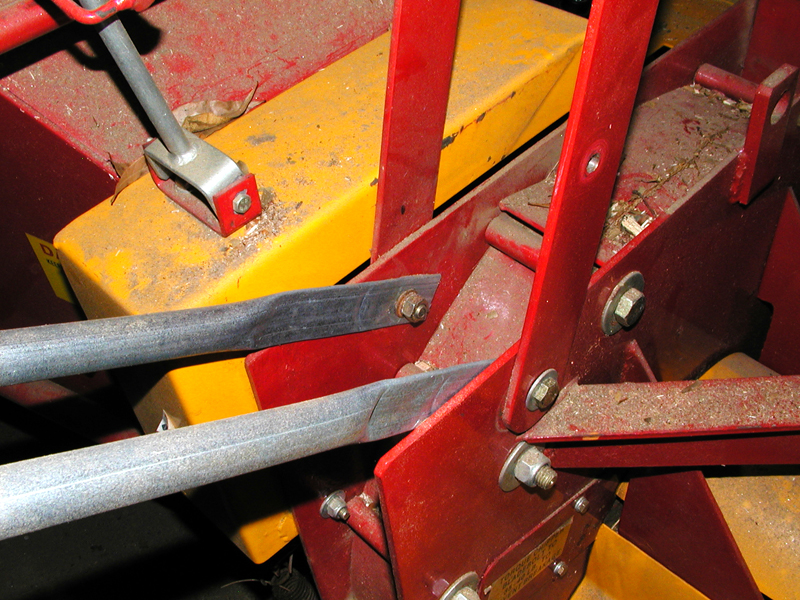

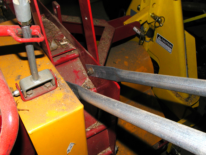

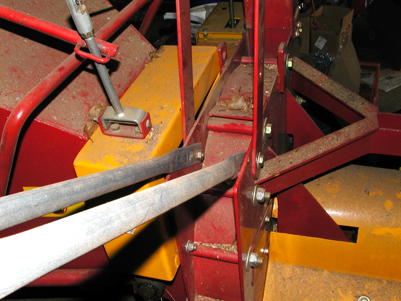

Larry,
As you requested, this post and the next will include some photo uploads of the attachment points for the downchute. The batch with this post shows the attachment points for the EMT tubing to the chipper.
Terry

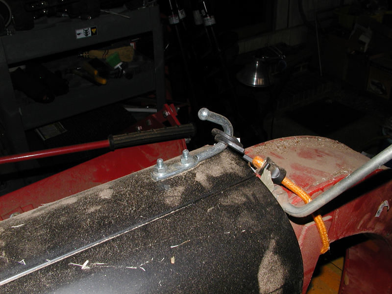

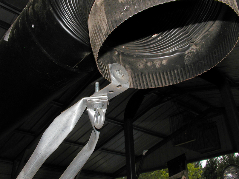

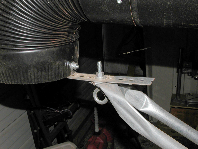

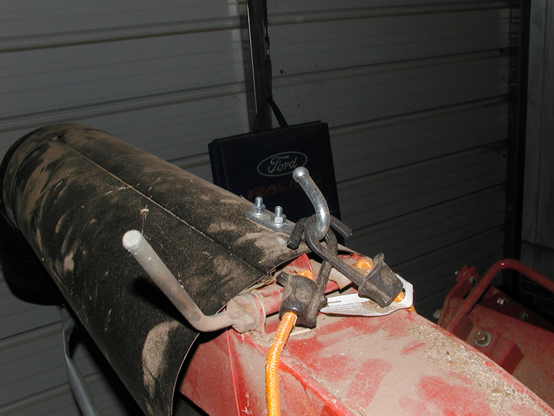

   / Jinma (Farm Pro) chipper downspout
#13
This post includes a batch of photos of the attachment points for the EMT tubing to the stovepipe elbow and for the stovepipe straight tubing to the chipper's chute (using a hook and bungee cord). You may also notice in one of the photos of the elbow that we used pop rivets rather than metal screws as previously stated.
Terry
