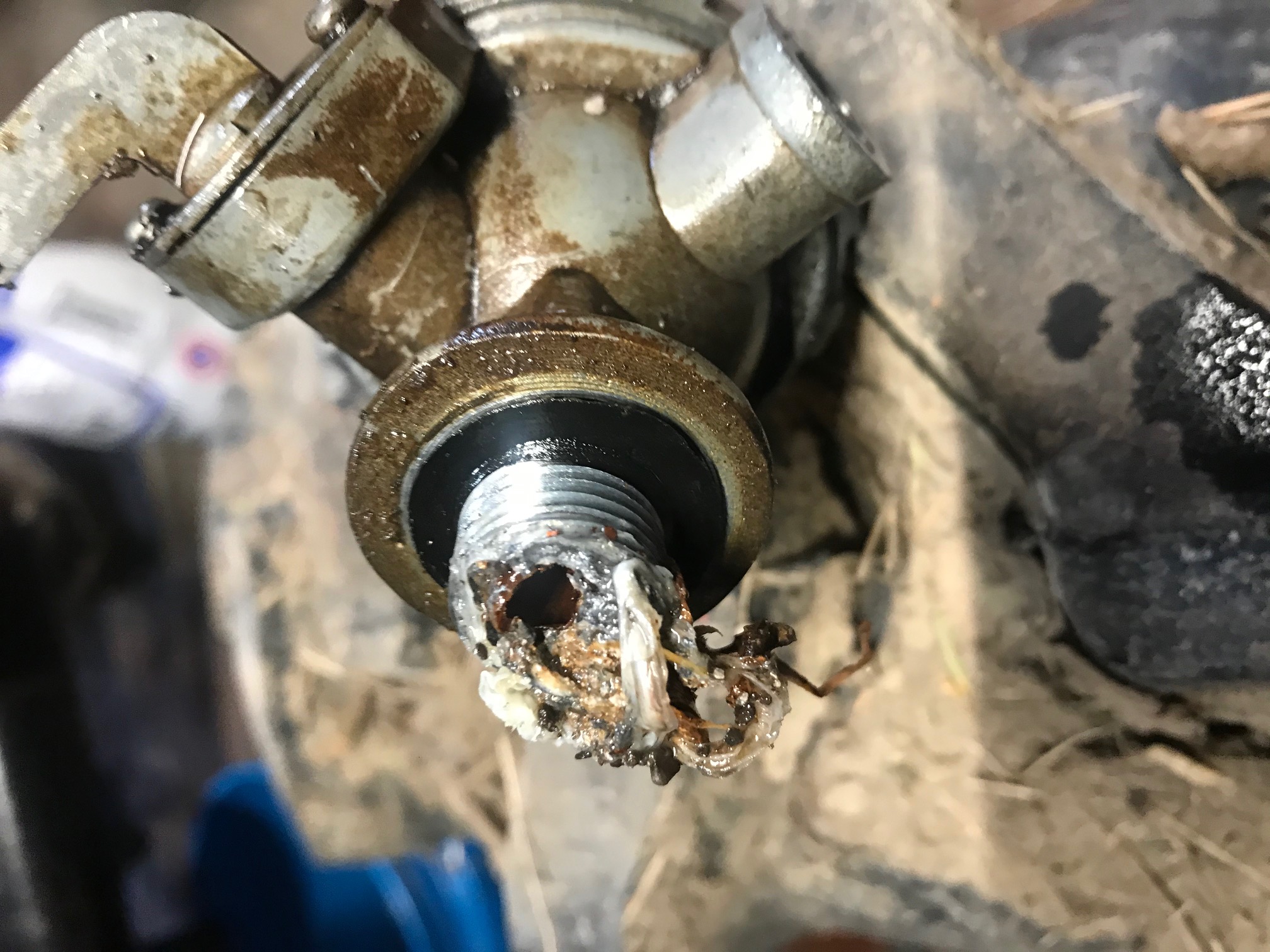

While I can see just replacing the plastic bowl with a glass one that would be the last route I would take. But I guess that is obvious since I put on Ronalds kit.
Using the OEM set up you still have the hidden in tank filter that is so troublesome, a leaky shut off valve which in my case would not fully shut off the flow, and a fuel line that was breaking down internally. I ran some Bio-Diesel B20 though my tractor a few years back so this may have led to this issue.
Either way Ranch Hands kit is well thought out and put together. It has all the nearly impossible Metric to SAE adapters needed along with quality fittings for the banjo bolts. This is not rocket science like some on this site like to make it out to be.

I know this is an old thread- I just bought my 2006 with 25 hours on the tach. It obviously had been sitting a long time. Here's what my in tank filter looked like when I switched to this new sediment bowl kit.
