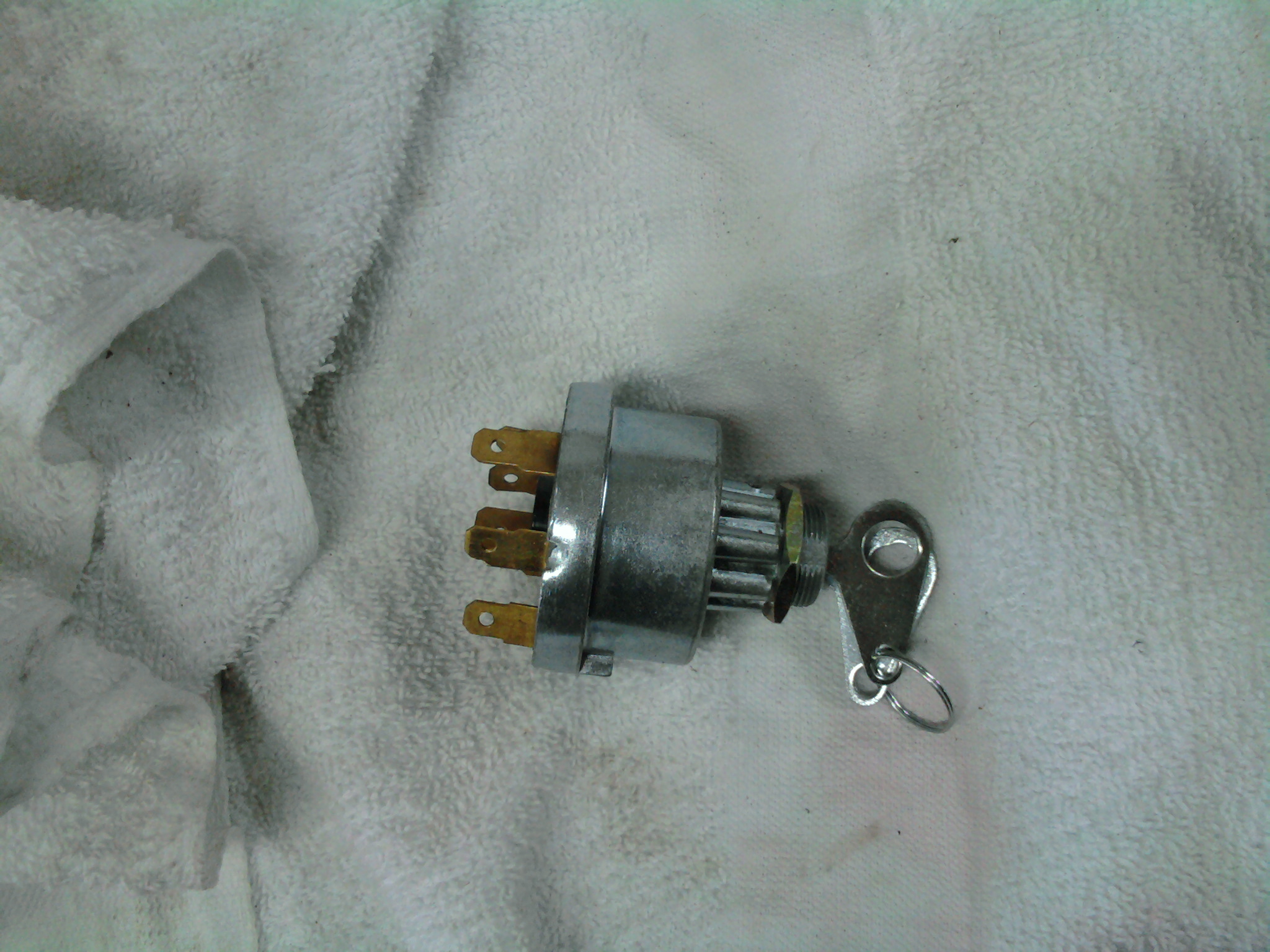

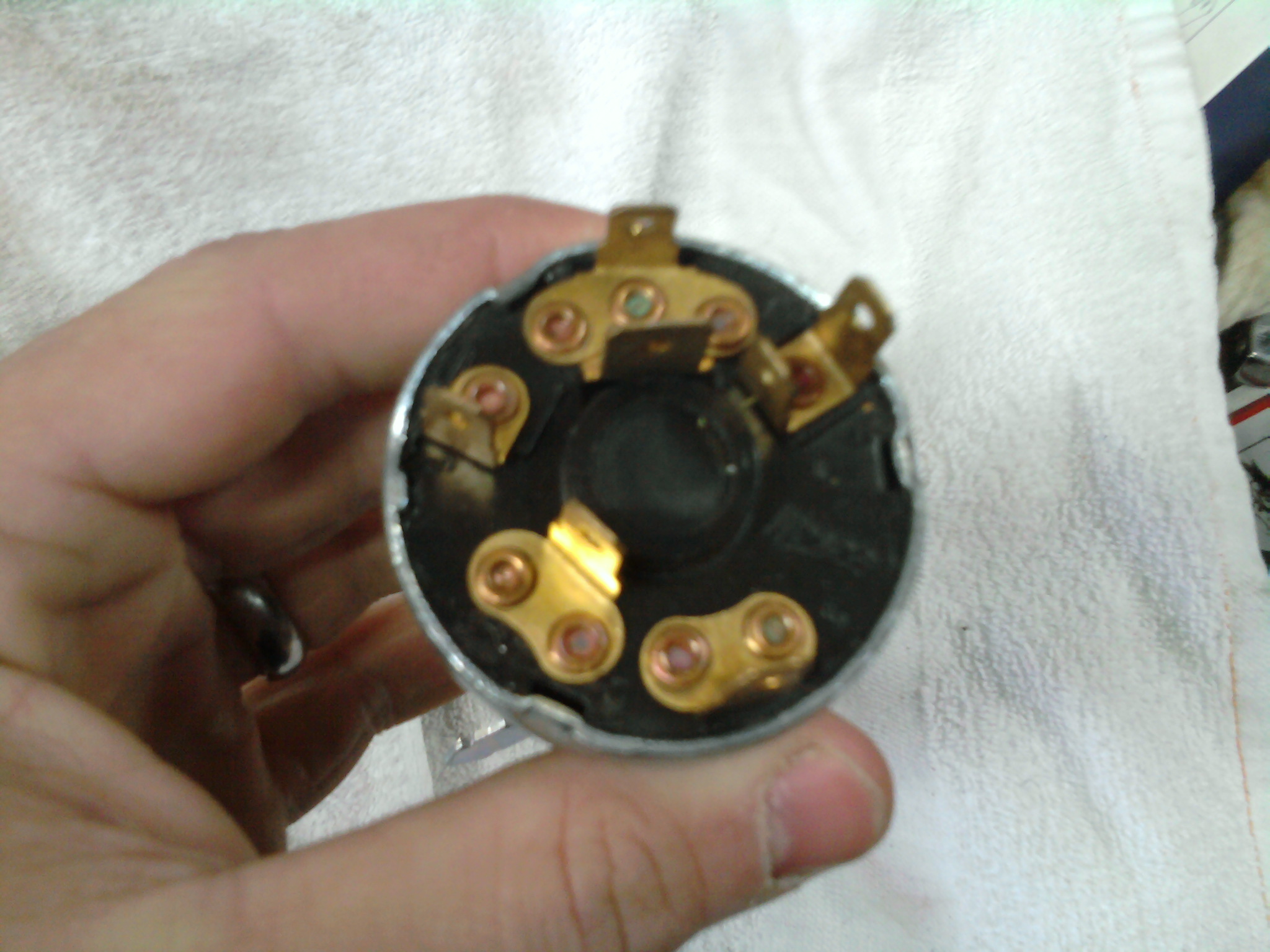

let me know if these come through

   / Jinma FYI #16
that key switch look exactly like the ford cold start i bought at my local auto parts store but i was thinking it was less than 10 bucks
   / Jinma FYI #17
Yup. That's a Chinese aftermarket copy of the Ford/Lucas switch. They typically run in the $10-$13 range. Significantly inferior to an actual Ford or Lucas switch, but much more available - and a helluva lot cheaper. Real Ford and Lucas switches are in the $65-$70 price range (new), but likely live longer than most Jinmas. That said, and despite the low price, the farm/auto store and eBay Chinese clones will still outlast the OE Jinma keyswitch.
