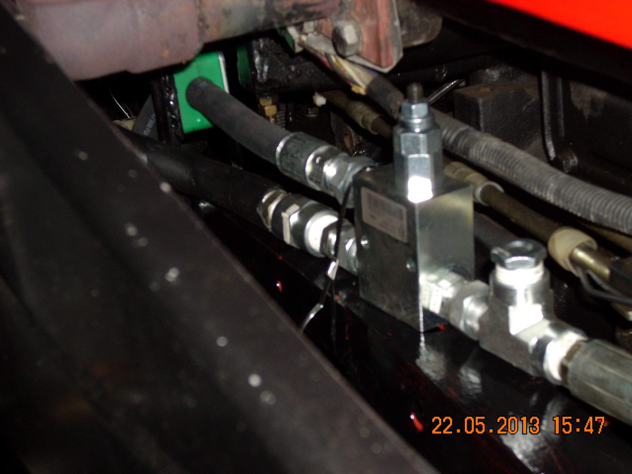

Hi guys,
Thanks for the interesting comments, I am always learning something new. When clearing snow using both the TPH snow blower and the FEL, it is normal for both to be in the raised position when moving from one place to another. I have done that for years and don't think that is the cause of the pump blowing. Having said that, the TPH blower isn't raised any higher than needed, whereas the FEL is used as needed. Obviously when blowing snow the blower is on the ground and the FEL usually a couple of feet off the ground - high enough to clear the newly cleared snow edges of the driveway/road.
I am thinking that the cause was probably the QD's connects though I will never know for sure.
To add to my other comments, I have now installed a pressure gauge and the original Jinma QD's have the internals removed and are now open.

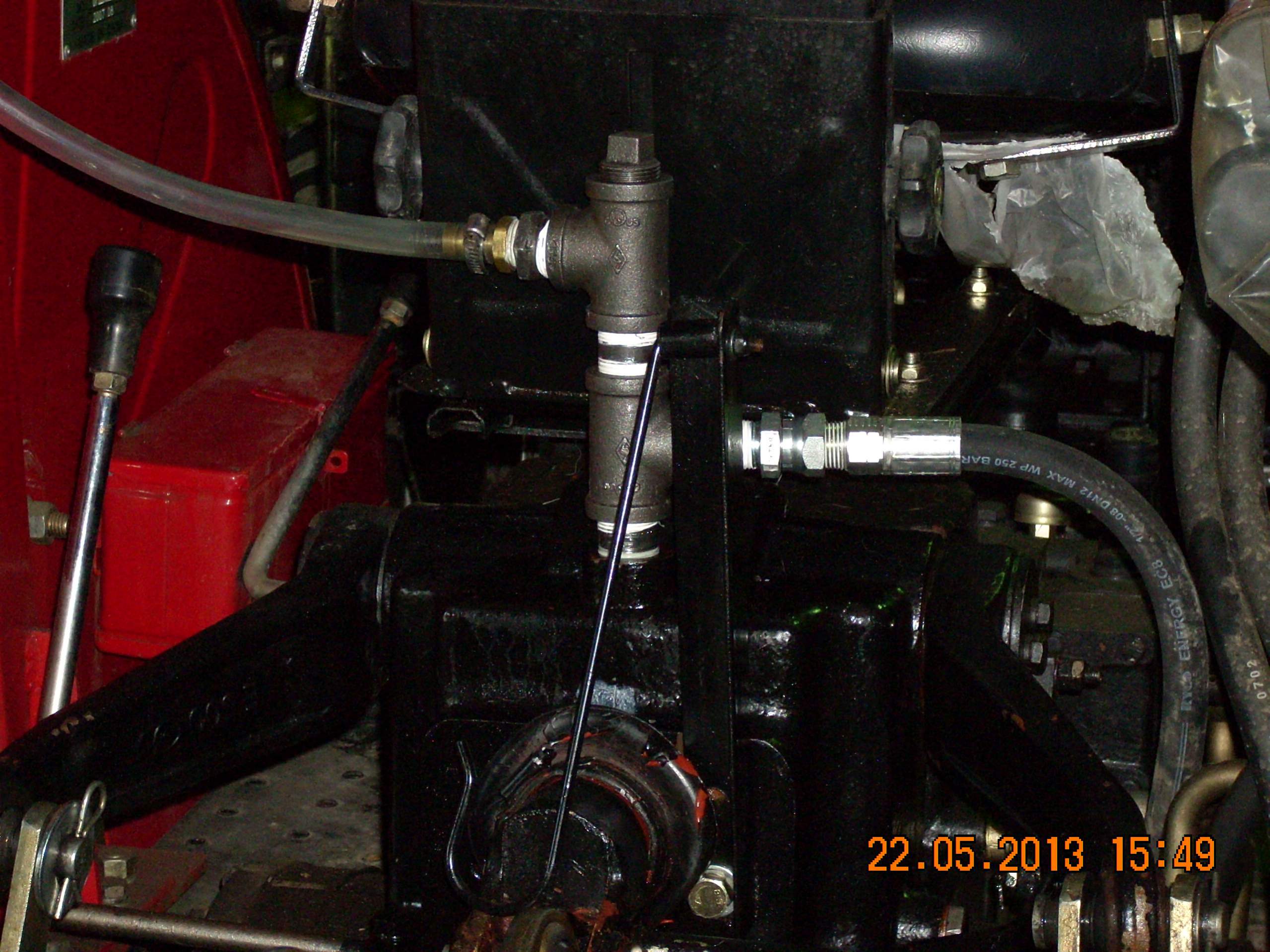

I will put in an extrenal relief valve along with a dedicated dump line back to the hydraulic oil tank. I still have to make up my mind on where to connect the relief v/v return at the tank - either at the drain or at the top of the tank.
Thx

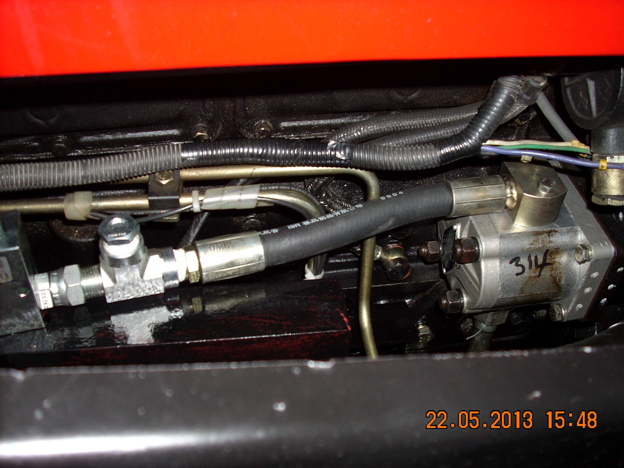

Replacing a 14ml/r pump with a 20ml/r pump, an almost 50% increase in volume without increasing hose and/or fitting internal diameters. Has anyone else done this? I've never tried so I'm curious of the results. It would be ok at low rpm but I'm thinking oil flow at high rpm through the loader hand control and quick disconnects would be restricted. Restricted enough to cause pump damage?
   / Jinma Hydraulic Pump - Failures
#30
Circle D - I think you are on the right track. I did not have the extra direct relief valve installed when I put the 20ml/r pump on. Thinking about it, I am sure that the original system would be marginal at best, but with higher engine RPM, failure would most likely occur quickly. That is what happened in my case I am sure.
I should mention that when the QD are removed from the pump outlet (pressure side), you will see the hose to the FEL valve block has a smaller internal dia - maybe 5/16" dia at most. The short pump discharge hose has a bigger ID of around 1/2" The relief vales in the valve blocks may not be too efficitient IMO.
I have since added a 10gpm external relief valve in hyd.pump discharge line and set it to open at 1800psi (18 bar). For what I need the 1800 psi pressure is adequate. I have the hose from the relief valve returning to the hydraulic tank. Set up seems to work well so far. Will try to attach a couple of foto's (taken just a day or two ago) to show what I have done - very similar to what other owners have done also.
Without the extra relief valve it will become expensive - the external relief valve is essential IMO.
Cheers
Jim
