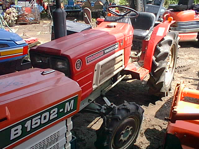

Actually there is such a thing as a YMG2000. They are built more like the YM2001 or 2002 models. Attached is a YMG2000D. They also have a 3 cylinder engine instead of the 2 that is in the regular 2000.
