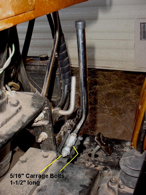

Here is a shot of the handle installed.
1/2" conduit 12" long pressed flat on one end.
Drilled two 5/16" holes and installed two 5/16" carrage bolts.

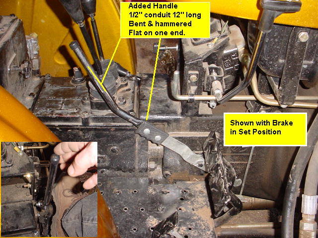

Picture three with parking brakes in the set position.

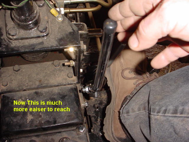

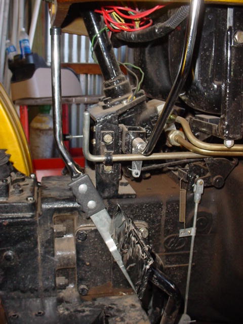

With the handle installed it is now much more eaiser to reach.
There is no interference with shifting, getting on / off the tractor, or the decompression lever.

Last shot, to show how it's attached.

I like the mod, I think I'll give it a try. Did you drill the brake lever with the lever installed or removed?
   / Jinma Parking Brake Mod
</font><font color="blue" class="small">(
I like the mod, I think I'll give it a try. Did you drill the brake lever with the lever installed or removed? )</font>
The Brake Lever was drilled in place - I did not have to remove it. I did set the brake to help hold it in place while I drilled.
FYI that brake lever is made out of some pretty tough steel, it took awhile to drill through it.
