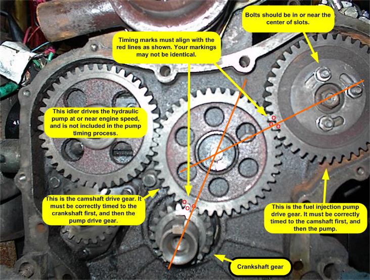

its a loss cause the pump is leaking from every seal and o ring i have a new pump in the garage just need the weather to stop raining to attempt to get this job done...not looking forward to it whatsoever
   / jinma rhino question(ABOUT TO PUSH IT OFF A CLIFF) #12
Warning !! Danger !! Like Rick has already said ... Don't remove the injection pump without some information. It is either gear or timing belt driven. It is critical to be timed in relation to the crankshaft. The job can be merely difficult to making the Jinma a basket case depending on the design.
   / jinma rhino question(ABOUT TO PUSH IT OFF A CLIFF) #13
Maybe someone can help with this one. i am replacing my injection pump due to it leaking at every orface (What's an orface?) now.. the breather tank thing (What's a breather tank?) that bolts to it towards the front of the tractor is there a seal that goes between or is that separate i want to just order everything i need now. This looks like it is the gasket .Fuel Injection Pump Gasket | Jinma Tractor Parts, Farm Pro Tractor Parts | Circle G Tractor Parts
What is leaking from the injection pump? Fuel? Injection pump oil? Engine oil?
   / jinma rhino question(ABOUT TO PUSH IT OFF A CLIFF) #14
Familiarize yourself with timing the pump first before you even consider changing that $3.00 gasket, because there is a lot involved if you even hiccup during replacement.
#15
easy peazy replacement.. no issues about 45 min JOB and its up running and no leaks..
   / jinma rhino question(ABOUT TO PUSH IT OFF A CLIFF) #16
Excellent. Glad to hear you blissfully made it. I would still like to know what a breather tank is, please.
