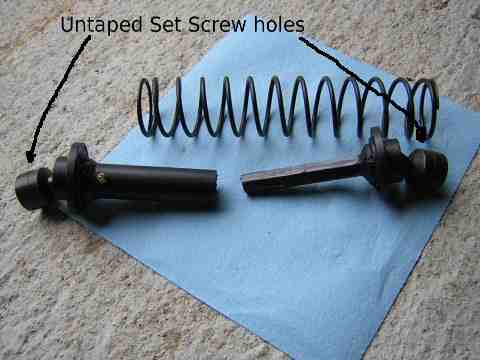

Al,
I found this post on another site that one guy was talking about the knuckles on the driveshaft popping out and getting damaged. He replaced the ends with socket universal joints. the second poster commented that there is a hole in the end of the driveshaft square scoket ends. See attached picture. He suggested taping the holes and puting set screws in each to keep the square shaft ends from pulling away from the gear box and the roller shaft. It made since to me that this was the real problem with the driveshaft, that was causing the knuckles to break. So I picked up two 3/16 set screws and a 3/16-24 tap from TSC and tapped the holes.
I've run about 14cu-yards with no problems with the driveshaft.
See link to TractorPoint.com
TractorPoint.com JM6 driveshaft problem
Userid: kwschumm :
"I believe the big problem is that the female square end can cock and cause the male end to round off and eventually shear. The female square end of the driveshaft has two holes in it that can be tapped for set screws. That should keep it from sliding back and cocking. It looks like it was designed for this but for some reason they didn't bother."
Hope this helps,

   / Jinma wood chipper disk moved within cage #12
Kieth
Thanks for the response. I see what you are saying but I thought the holes were to allow grease to enter the end housings. I found a post where the male and female ends were not cast the same. The poster discribed grinding the long end to match the short end and that elminated the binding on my shaft. Ginding Ends to Match It is still a pain getting grease into the ends but I use a needle injector and that seems to get the grease in. If I have a problem in the future I am going to consider the 1/2" impact u-joints.
Al
   / Jinma wood chipper disk moved within cage #13
</font><font color="blue" class="small">( It made since to me that this was the real problem with the driveshaft, that was causing the knuckles to break. )</font>
While it may make sense I think that it's only part of the problem ... I put the set screws in mine and ended up grinding off one of the male ends that fit in the ball and socket joint (probably the one that was described as having a poor fit and binding.) I picked up the 1/2" impact u-joints to do that as a fix but have been too busy to get around to it.

#15
Randall,
I agree, I also made sure the ball joints were operating smooth. I still believe that if you can keep the sq. socket joints from sliping off, the ball joints won't bind and jump their circlip's. time will tell, I'll keep the impact u-joins in the repair list if /when it fails.
