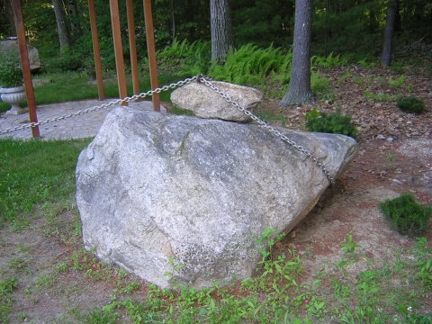

I'm on the road for a couple of days, but as soon as I get back, I'll stage a photo with one of the bigger rocks that we moved with it.
The technique involves more rolling the rock than dragging it.
You can roll it or twist it depending on how you wrap the chain, and use a chain not a snatch cord. A snatch cord stretches and therefore stores energy which is violently released if something breaks. If the chain snaps, things just drops and you can cover the chain with a moving blanket as a dampener if you want a higher safety margin.

As promised, here's a picture of the rock moving technique using a fulcrum rock. This method allows your tractor to roll and position rocks much larger than you think. This rock was positioned with the tractor and is 6'x4'x3'. The fulcrum rock is about 200 lbs.
The technique works to flip rocks as well as spin them around.
