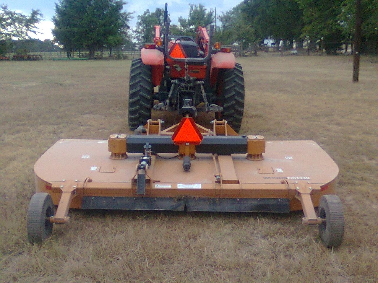

Are you mowing a full 90 acres? if so, get a 15' bat wing. I know it's a lot of money but that 3' will make a huge difference in time. If you have that much field you might want go up in size at least one tractor.
   / John Deer 5065 vrs Kubota 5640 #7
12ft mower was a bit much for my old m6040 but the new m7040 handles it no problem. If it were me I would look at a 15ft batwing and m8540 or 9540 that's alot of grass. That's the route I took m9540 and 2615 bush hog and no regrets. The m7040 is back up with the old 12ft bush hog.

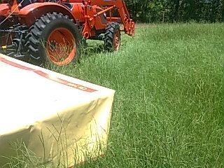

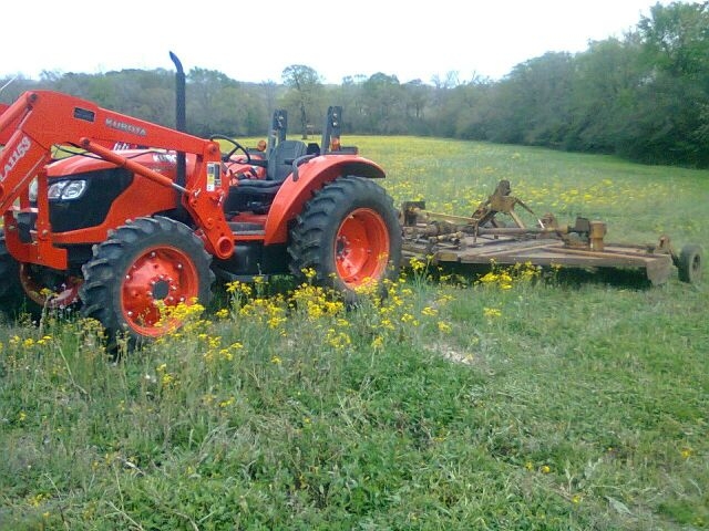

cutter up all the way.JPGrearviewbatwing.JPGmowing.JPGcutting hay2.JPG5040 and ds rear view.JPG
15FT BATWING
8FT HAY CUTTER
12FT WOODS
KUBOTA 5040(46PTO)
