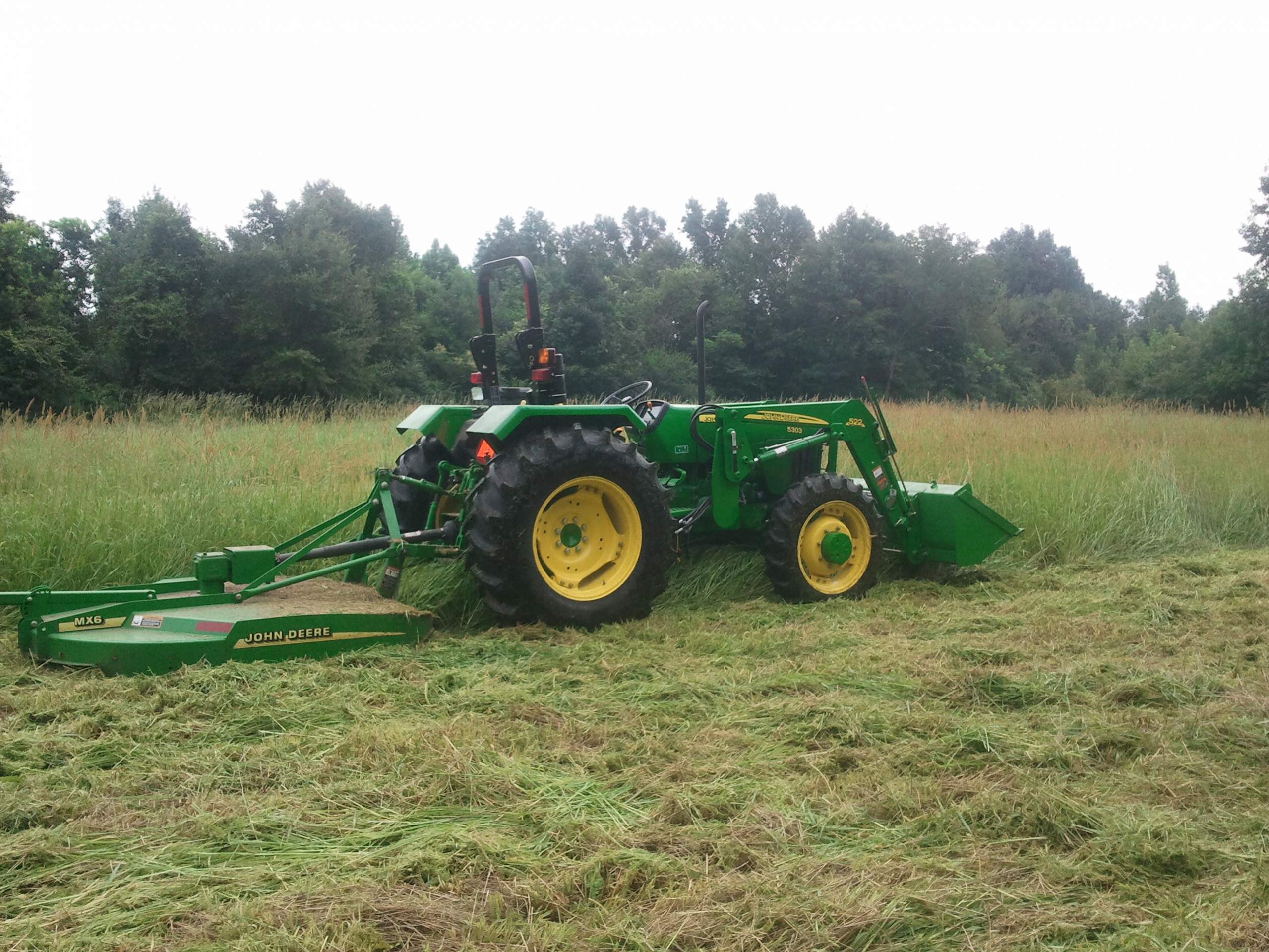

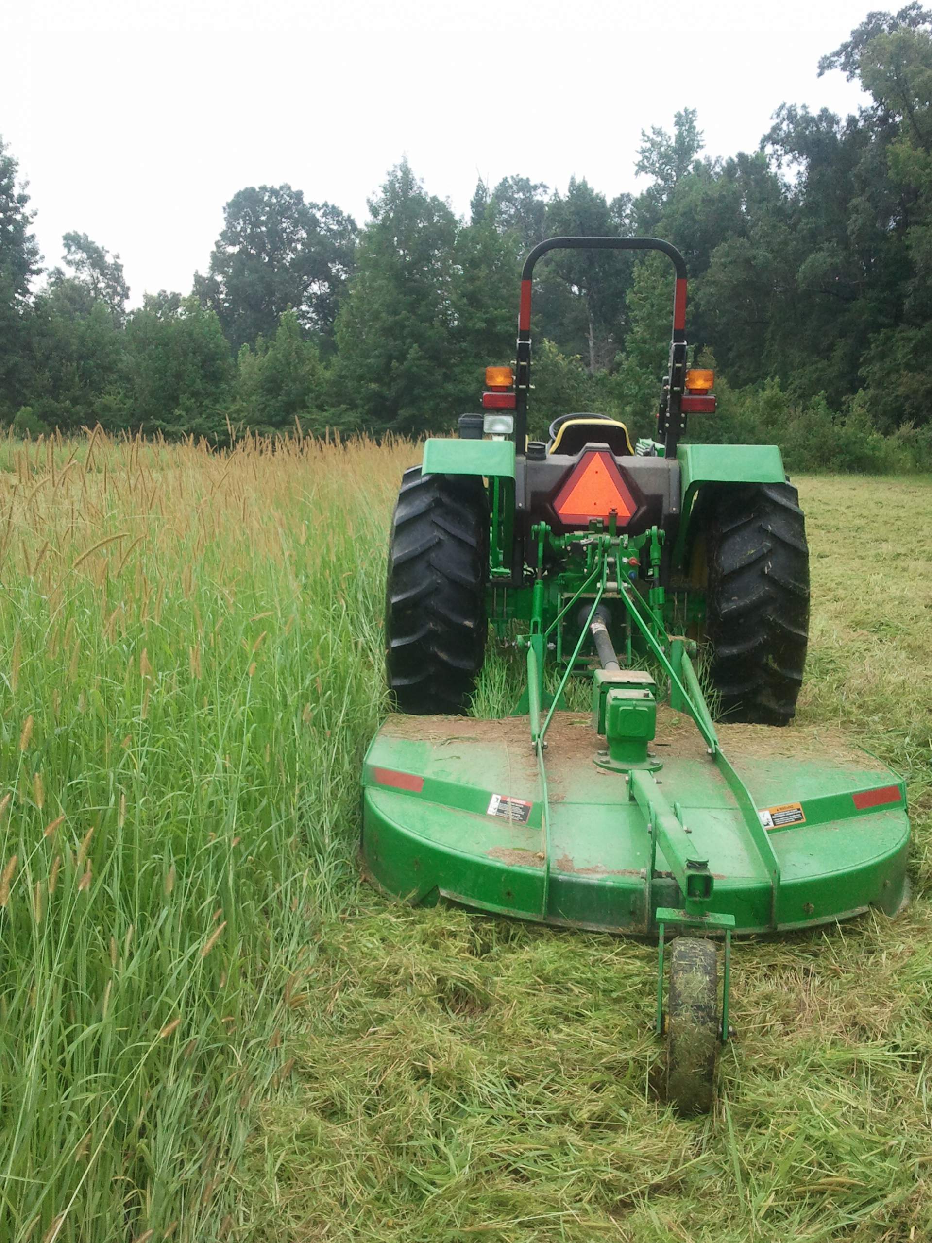

Attached are a couple pics of what I encounter and use to base whether or not the PTO HP would be adequate for the cutters mentioned. I have often wondered what a 10' or 12' or even 15' unit would do in these conditions with the 56 PTO HP I have available. I do a lot of woods road maintenance and have about decided the 6' is probably the best option for the all purpose situations I encounter.

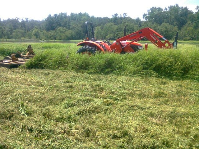

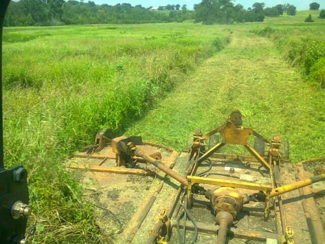

46pto HP KUBOTA and 15ft mowing bottum 4.JPGmwing bottum 3.JPGmowing bottum1.JPG 2nd gear LOW

In comparing the 15' cutter behind the M5040 vs the M7040, what level of efficiency or rating would you give the two? I am impressed that the M5040 would turn the 15' cutter in grass that thick and tall. My JD5303 has nine forward speeds. I typically operate in "B" range and 2nd gear. Believe this is around 4 mph, but not sure. If the field is smooth and the grass not too thick I can run in "B" range and 3rd gear. Not certain, but I believe the ground speed bumps up to around 6 mph to 7 mph. The cut quaility does go down some at the higher speed.

I havent pulled the 15footer with the 7040 yet,the shredder is at lease place. I will say not going to go any worse than this,with the 5040,it got a work out.I could have pulled it faster but wonted to take it easy on tractor and get a good cut. 2nd low kept the tractor at full rpm's without bogging it down any,the 7040 should run it just alittle better,but then again thats running a/c and radio:D
