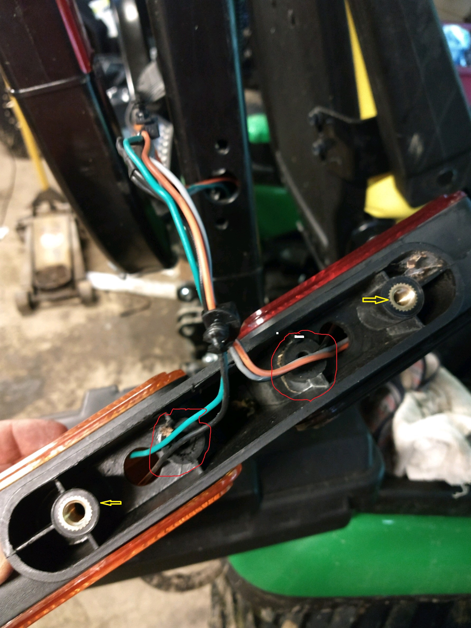

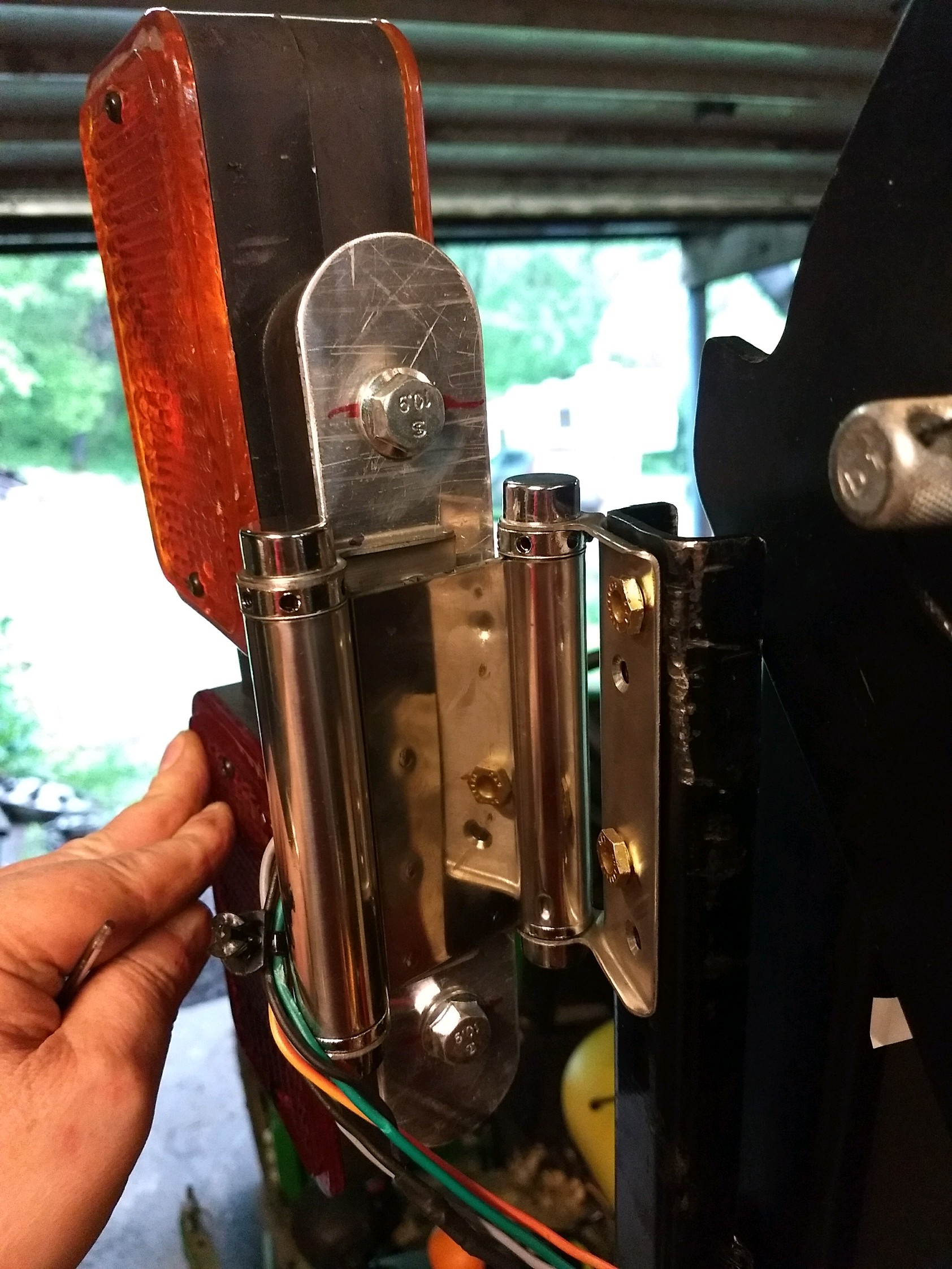

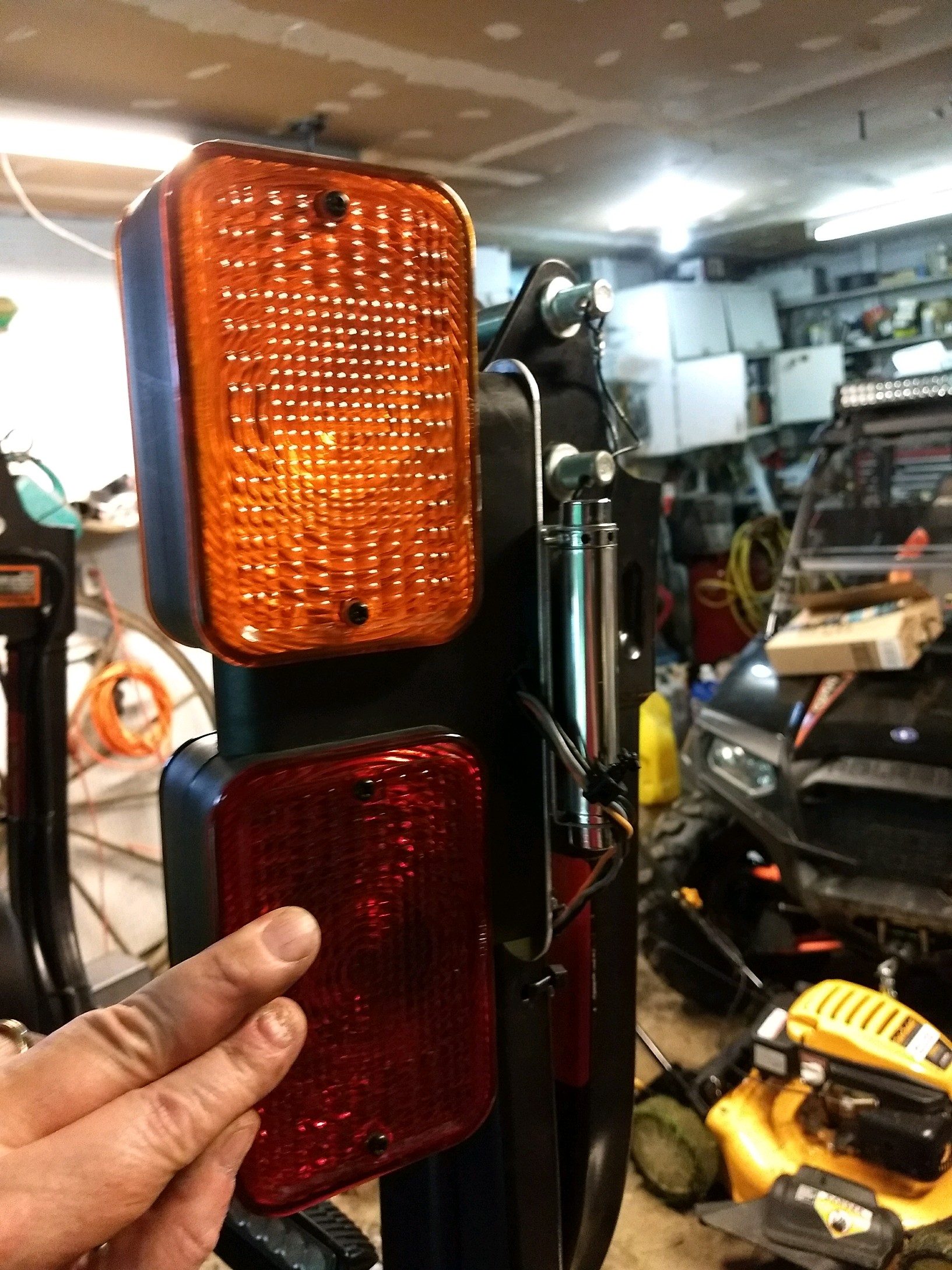

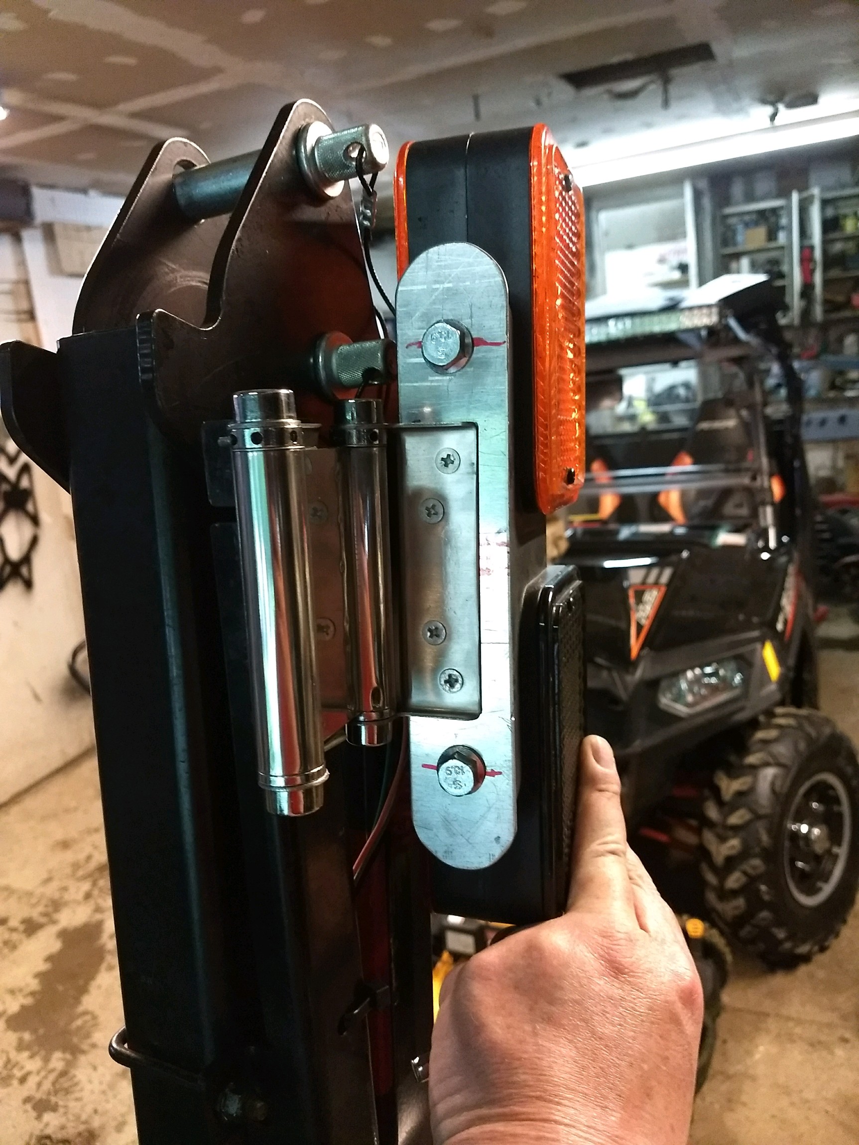

I see from several forums that there are a few of us (like me) having problems with tree limbs breaking our ROPS hazard lights and these **** things aren't cheap to replace. Though I try to be careful not to hit them it seems the limbs jump out and grab them.
So after a little brain storming I came up with this cost saving solution.
I bought stainless saloon door hinges and installed the on the lights.
Hopefully this will let the lights fold out of harms way without breaking.

You can also swap them to the inside........................unless you have a hoe.

I've seen that done that way unfortunately I have the back hoe.

I was cutting grass today and hit the driver's side light on a limb it folded back and sprung back to it's original position. No damage done!! I love it when a plan comes together!!!
