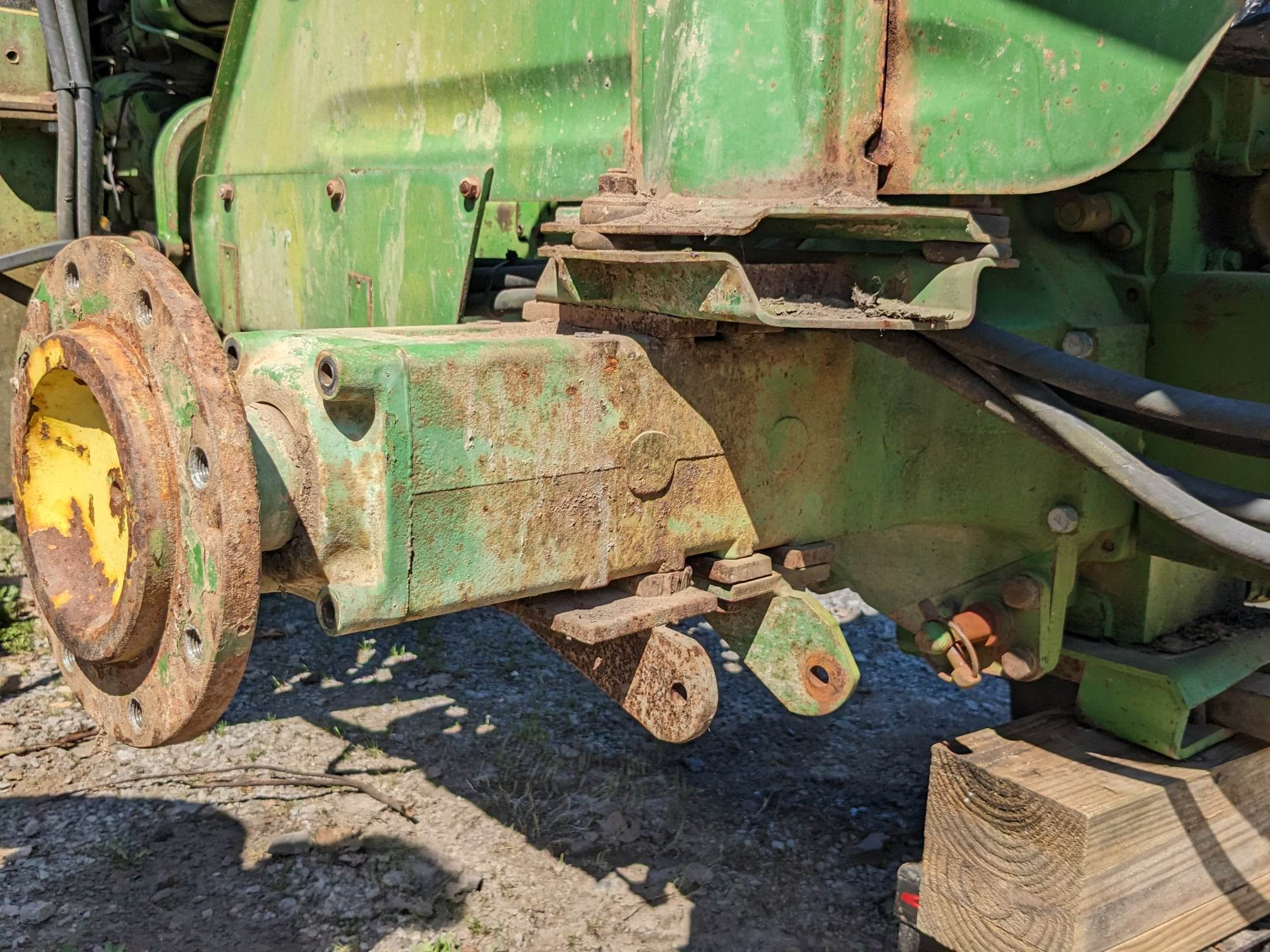

In an effort to free up a frozen brake on the left rear wheel over the winter, I apparently lost the drive on the left rear. The right rear only drives when the differential lock peddle is enguaged.
I have started to disassemble to gain access to the axle housing but have not removed it yet. I did removed the ledt brake cover and found a little.watrer and corrosion on the spring and hardware. The shoes appeared new and the drum surface was smooth.
Before for f go further I wanted to search out some guidance from members who have performed this type of repair.
Thank you in advance for any help that you offer.

This is an often enough occurrence at times for these Yanmar made Deeres. A few YT vids are out there.
Should you need manuals for free, come check us out.
And the Yanmar/Deere/Cub Cadet brake axle repairs.
   / John Deere 1050 4WD - Lost Left Rear Wheel Drive #3
You probably sheared the brake pinion shaft. I've done this on a JD2030 & a YM1610
