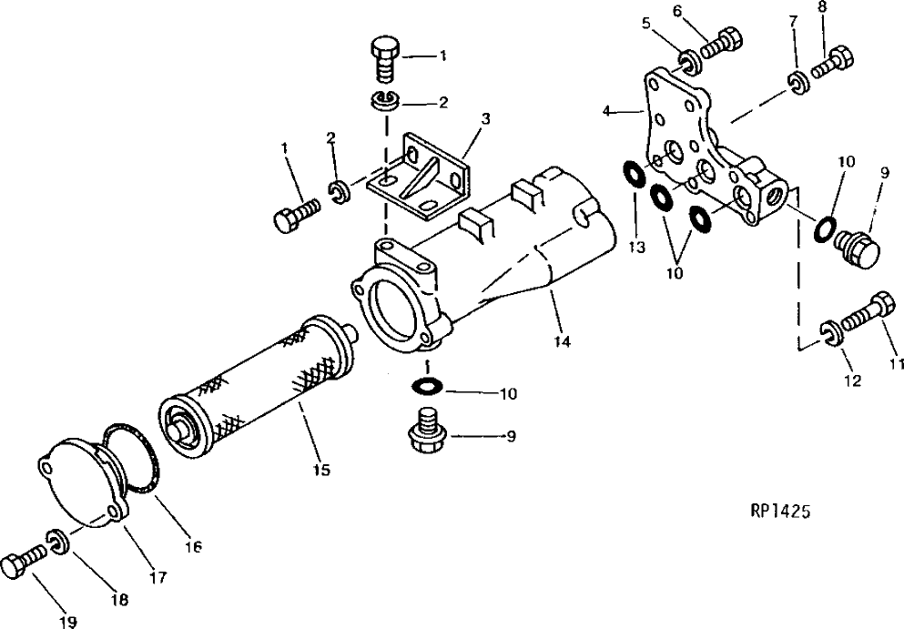

The screen is under the left side of the transmission. Remove cover #17 to access. RP1425_________UN02JAN94.gif

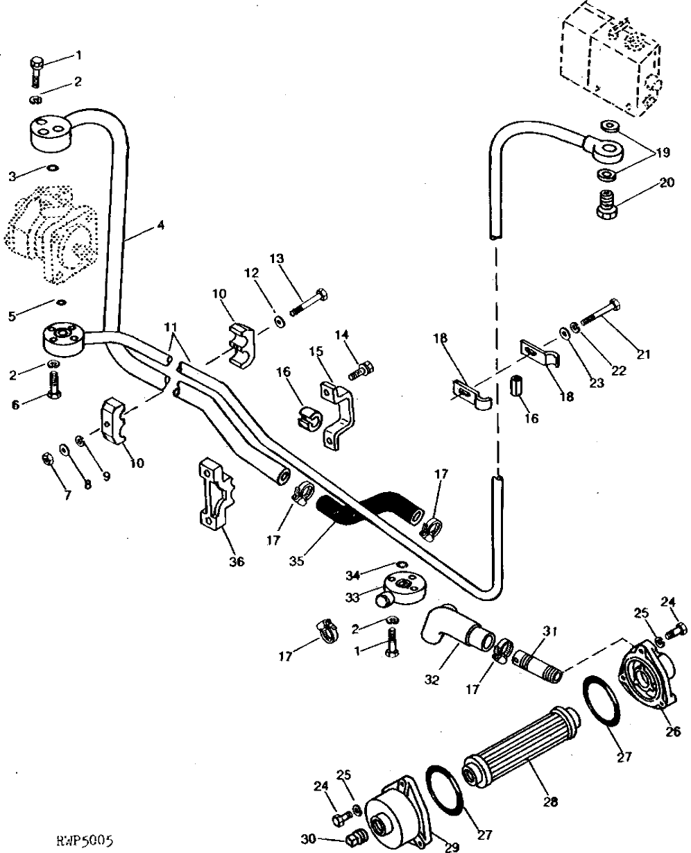

Here's a parts catalog photo that may help you find the screen. It should be laying across bottom of trans case.

We found it pulled it, cleaned it and it's working fine thanks everyone for your help. Greg
