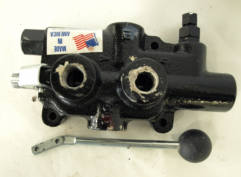

#17
New Prince Standard 4-Way Control Valve, Model# RD2575T4ESA1 (2010)
Up to 20 GPM with 4 ports. Factory pre-set at 1500 PSI, has adjustable relief valve. For lower pressure, turn counter-clockwise. Adjustable from 1000 to 3000 PSI. Precision honed and plated, spools are hydraulically balanced. Spring centered. 3/4in. inlet/outlet ports, 1/2in. work ports. USA
Max. Flow (GPM) 20
Inlet Port (in.) 3/4
Outlet Port (in.) 3/4
Working Port (in.) 1/2
Max. PSI 3,000
Directional Control 4 way
Adjustable Release Pressure PSI 1,000 - 3,000
would this one work for me
   / john deere 1070
#18
do I need a 4 way/3pos valve
Im not sure but I think I have a Double acting cylinder if it has 2 hydraulic lines on it ?
