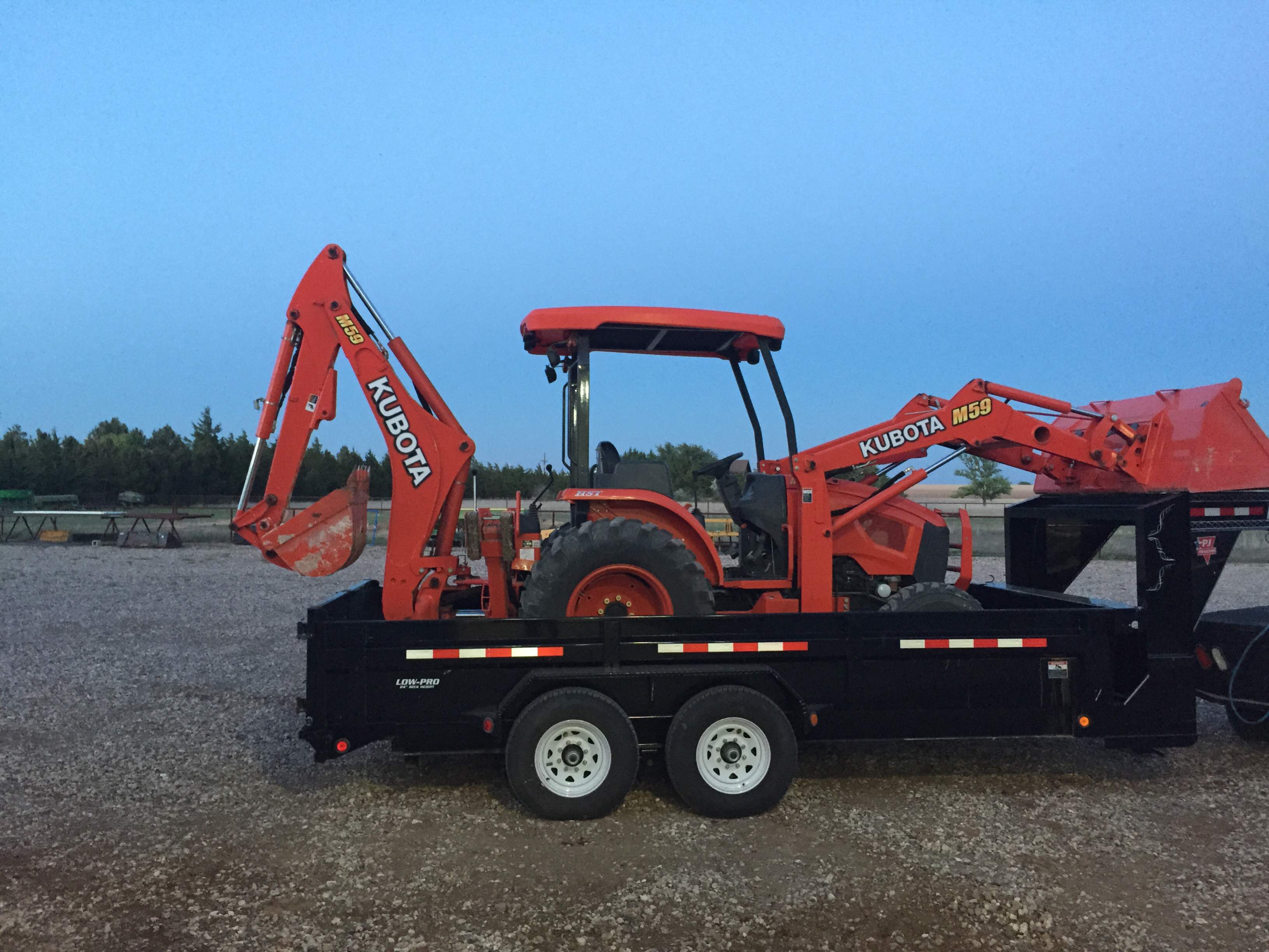

I haul my kubota M59 backhoe on a 16' PJ gooseneck dump trailer. It fits fine. I set the bucket on top of the gooseneck (chained down) and the hoe bucket barely sticks out the back. My backhoe has a pin and latch to keep it from moving while in transport so per the regs it doesn't have to be chained down.
I am not positive but I think the M59 is bigger than a 110. Mine is around 8500lb.

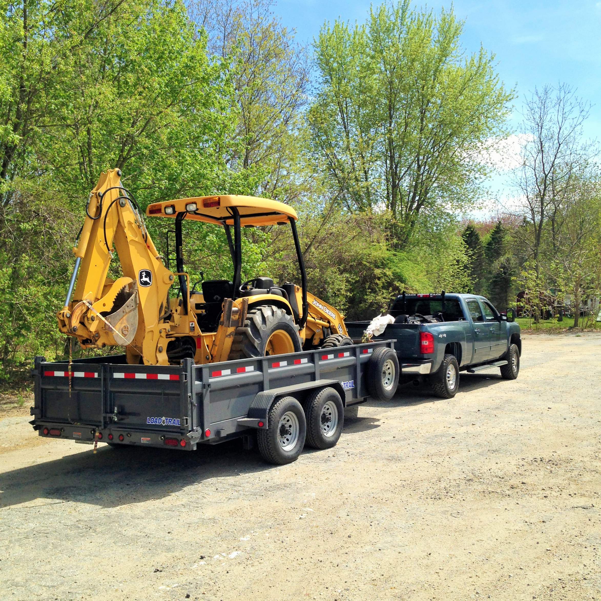

The M59 is a little larger than the 110, not sure about Texas regs but I've spoken to the local DOT cops and they say the pin doesn't meet the requirements(the 110 has the pin also). IMG_1071 (2).jpg

I refer to this thread. It appears to be a direct quote from federal regs. Tractor Transporting Discussion Board - Re: Securing Loads
Specifically about halfway down there are three questions with guidance answers regarding securing buckets on TLB's and it says not required with locking pins. My M59 has two pins one to prohibit side to side movement and one to prohibit up and down.

The problem is that the regs are vague at best. I guess a person could roll the dice and hope that the DOT officer happened to read the link provided by bdog and uses that interpetation, but it could be a major hassle if he didn't.
The index for the manual is here 49 CFR 393.128 - What are the rules for securing automobiles, light trucks and vans?. And here is the section regarding over and under 10k http://www.gpo.gov/fdsys/pkg/CFR-2011-title49-vol5/pdf/CFR-2011-title49-vol5-sec393-128.pdf.
