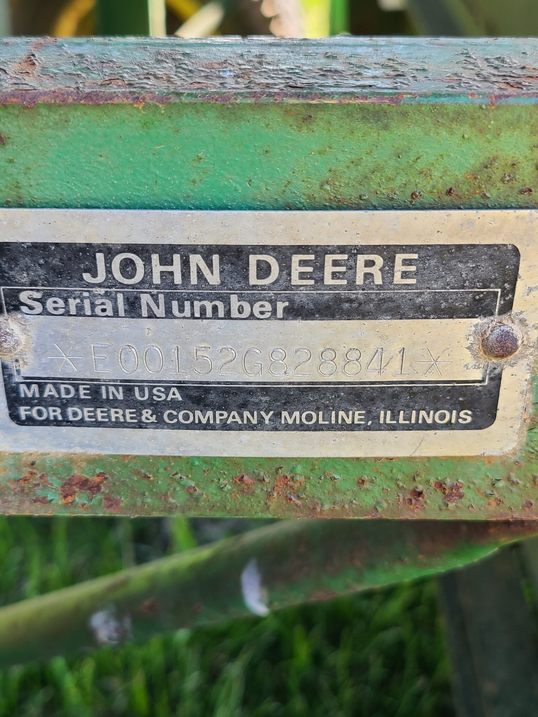

Anyone ever mess with one of these? Picked it up today. Cleaned the carb and it runs pretty well, but doesn't seem to have a ton of suction even from the side hose when I connect that. Any ideas? Sources for a manual and parts would be awesome too. What is the value of this thing? It's not rusted out inside most of the paint is still there.

its a 1989 model!
   / John Deere 152 lawn vacuum #6
its a 1989 model!
Right, did you find the part(s) you were looking for? Probably the blower fan will be hard to find, but the impeller for the 152 is part #AET10770 .
