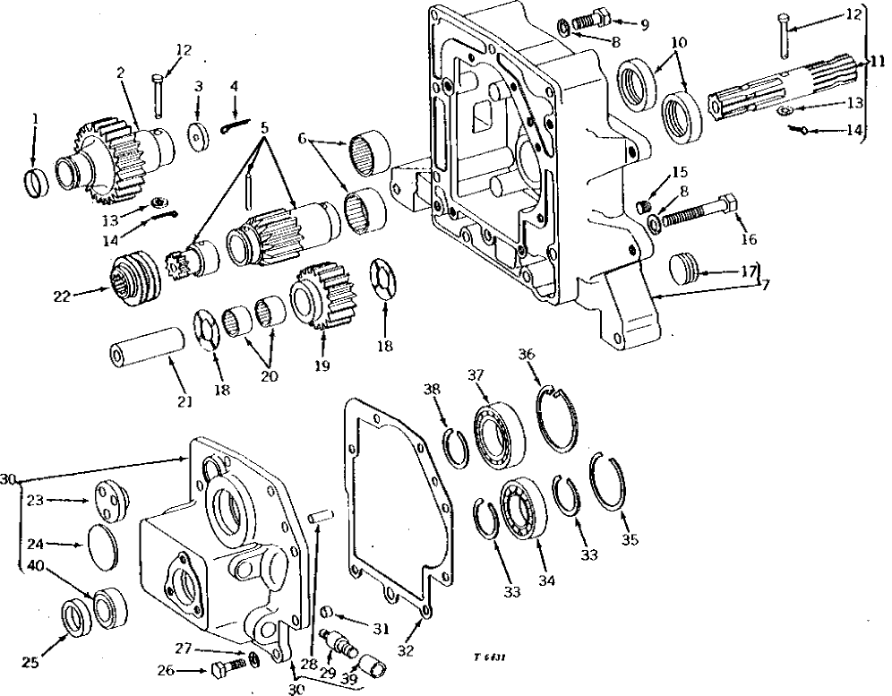

I'll 2nd for you to enjoy your 2010 as I've previously stated an old saying:
One can't tear up a good 2010 nor can they repair a bad 2010.
I hope you never experience problems with the pto shift collar(parts key 22) or gear(parts key 5) as those parts are NLA
