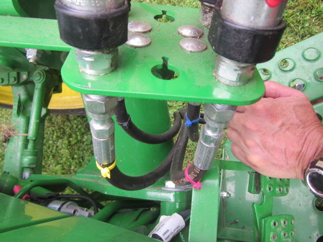

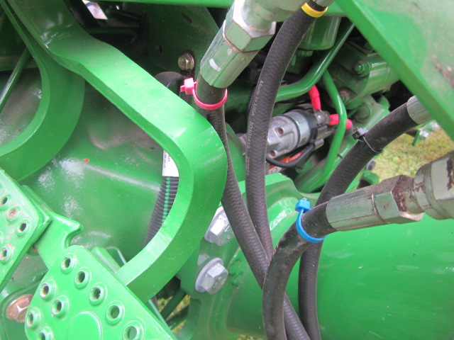

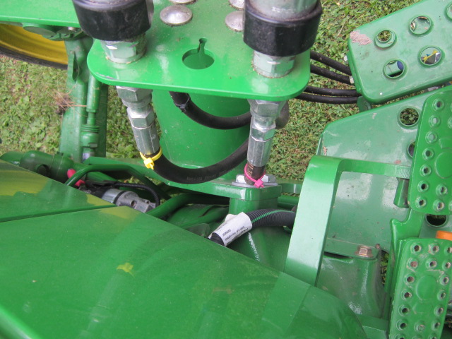

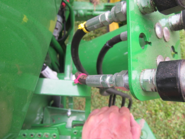

After doing a search on Google, I found this problem being discussed on this site. I am having the exact same issue with a 5045E, 2014 or 2015 model, not sure which year it is exactly. Only 55 hours. My son actually uses it more than I do and brought the matter to my attention just yesterday when he showed me one of the hydraulic hoses starting to be worn because of the excessive brake pedal movement on the first stroke down of the brake. Truthfully, I am not even sure the hoses for the FEL are mounted correctly to start with. I will try to post up some photos. I haven't talked to my dealer yet about this issue but sounds like I need to but if Deere isn't going to do anything about it, then I am not sure what good it will do!

Well that is a very different setup from my 2012 5045E . with a 553 loader. . My hoses run from the joy stick bottom below the steps then up the loader frame nowhere near the brake pedals.

If I found that set-up on my tractor (and without seeing any more than what's in your photos) I would add 90 degree fittings to the hydraulic coupling at the end of each hose to direct them away from that area (or at least that one hose). I would do it right away too, because the damage the brake pedal will to to the outer casings of the lines WILL result in a leak at some point, even several years down the road... That is not a place where you want a leak. It could ruin a nice pair of work boots! I also wonder if the plate the fittings are set in might not be mounted properly.

I agree with you on all counts!! Not sure they mounted the hydraulics correctly either! One of the reasons I have contacted another dealer about the issue. They have started a warranty claim on the concern. I was told that certain ser. numbers below some point were more afflicted with this problem than the newer ones. They won't know until they tear into it whether or not the brakes can be helped. Sounds like it may improve it but not cure the way they work. In other words, instead of the first pedal movement being 4 and 1/2 inches, it may be 3 inches when they are done. On the second pump of the brake instead of being 3 inches it may be 2. For me, the brake really doesn't work like it should until the 3rd pump. I will let you know what they come up with. They were to pick it up today.

I am not a mechanic so I won't do a good job of explaining this but my dealer did some research on the subject at the Deere level and told me that Deere is aware of the issue! Apparently they did make a change in the brakes at some point. I can't tell you which serial numbers they started the change on but basically, they can't make the brakes change to NOT have a difference between the first pedal push and the second but they CAN lessen the severity or the distance one has to push the pedal down by putting in a different (for lack of a better term) piston size. This will reduce the distance of travel. In my case, he told me that, even as new as my tractor is, it was before the change but that he bled the brakes and that they went from about 5 and 1/4 inches for the first pedal push to 3 or so and that is actually better than the new change. In other words, they never had to put in the newer piston but, I suspect if they had, it would have or could have shortened up the stroke even more. Also, since my pedal had been hitting the hydraulic hose they put in a 90 degree and told me I wouldn't have that issue again. As well, told me the hydraulic hose's were in the correct position as if they were put on the outside, they would be subject to having something get caught on them. Bottom line is, I guess, the way the brakes work is normal but it is not normal to have excess distance involved when you push on the pedal and there is a help but nothing that can change it to be more like our car brakes, for example. The second push of the brake will always be more like we all want than the first push!
