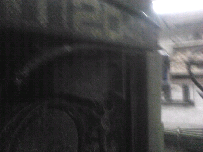

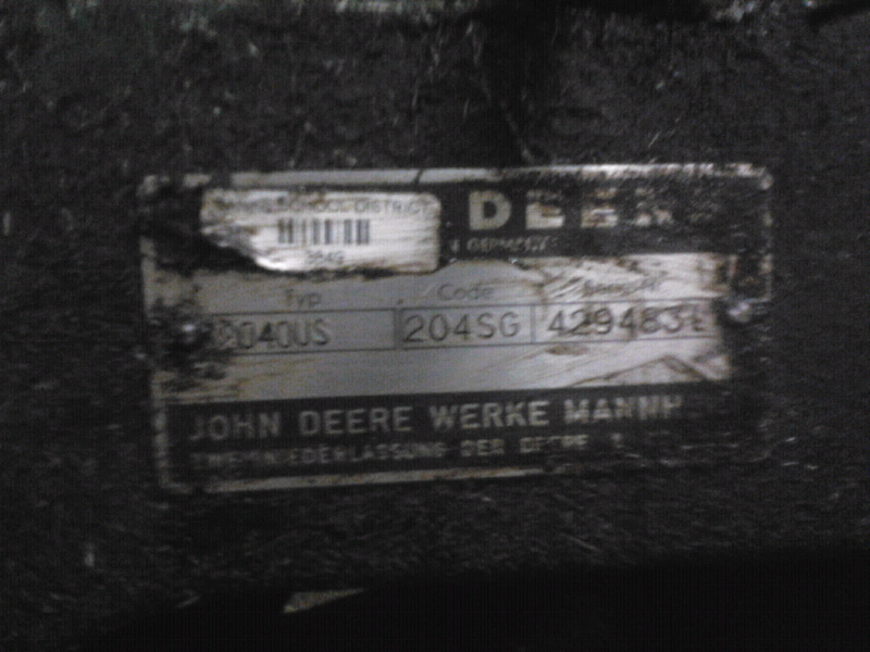

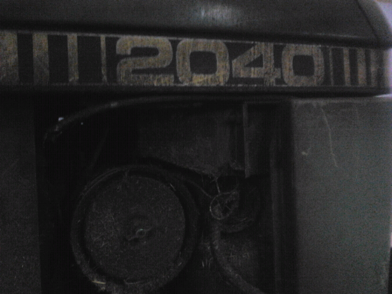

Monday in shop class i get to take the school's 2040 apart to replace a leaking hydraulic hose. To me I see it as an opportunity to learn a little about how the 2040 work's and get the hydraulic fluid off the shop floor as it is a hazard and liability on the school waiting for someone to slip and fall on the slick concrete. The problem hose is the siphon hose but to get to it requires removing the front weight, the hood, and many other things. Supposedly it is a 4 hour job, I guess we will see how long it takes. I attached a few pictures of the problem area and teh serial number, not sure if that will help me looking for a parts diagram or not, I will find out soon. Any procedure ideas to make it go a little faster/easier are welcome as well as any advice. Thanks guys! :)
