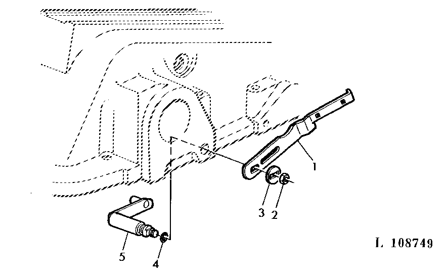

/ John Deere 2140 #6
Sometimes the stroke control valve in main hyd pump can get worn and hang up a bit. You might consider replaced stroke control valve. How many hours are on the tachometer? Parts key # 20 are the control valves for rockshaft. Where is lever(parts key #1 in 2nd schematic setting)? If not in "D" put it in "D"

/ John Deere 2140
Hi Jim, At a mechanics suggestion I replaced the main pump load control valve although I did not replace the seat as that requires removal of pump to press out and in the new one. The valve showed where it was contacting seat but did not think it was significant and it did not affect my problem.
My machine does not have an hour meter as part of the rev counter but best estimate is its 1985-87 vintage and has seen many hours in the field!
I assume you mean D is the lower position available which is Depth Control?

/ John Deere 2140 #20
From parts catalog photo that appears to not be that difficult especially after removal of rockshaft housing. Since everything's been changed I don't have a slightest clue how to download a photo.
