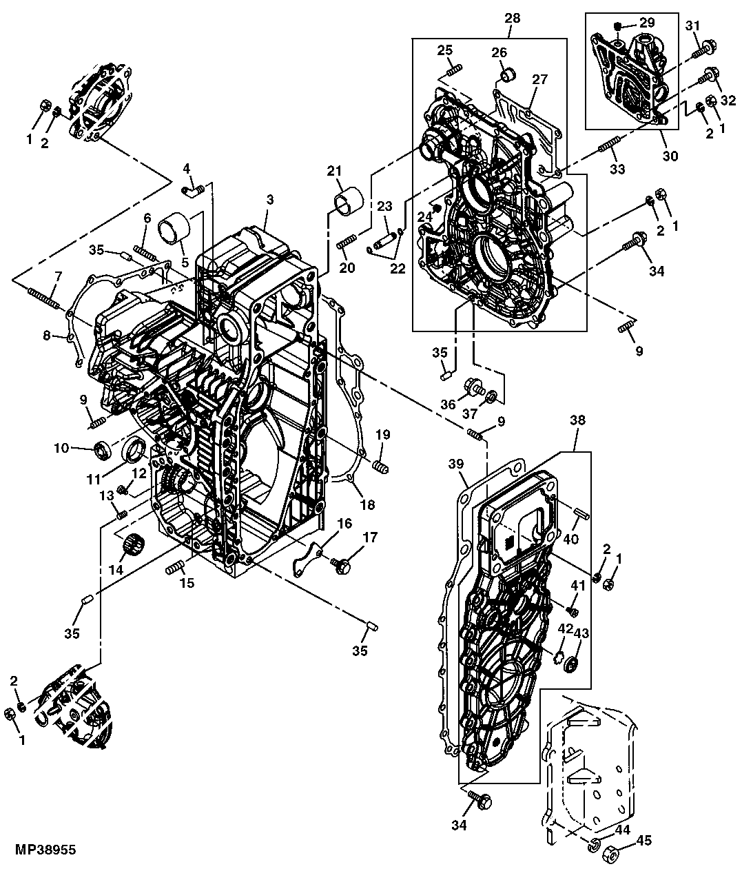

Part #3 in the diagram...

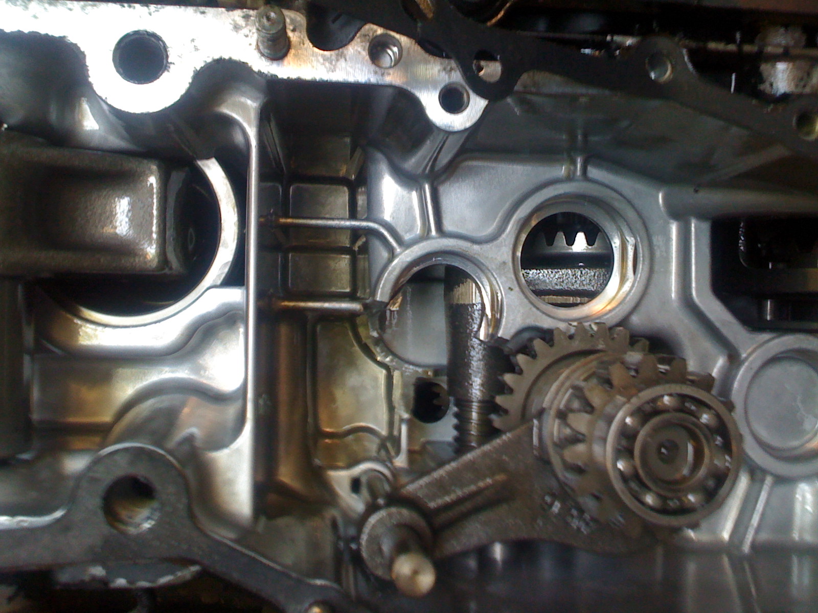

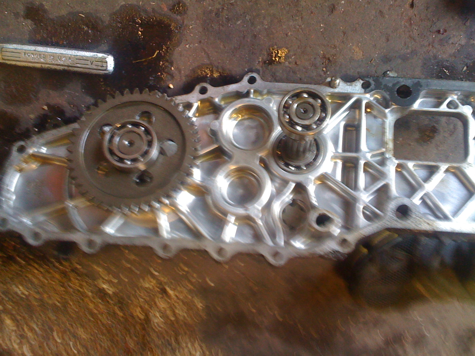

Yea, see attached picture. You can see where its busted. It looks like I am missing another gear or something else also. There was nothing touching the pto shaft. Anybody know of a more affordable way to fix this? Where do I find these parts diagrams.

The diagrams are available free from www.jdparts.com after you register-it takes a little getting used to but if you think like a "parts guy" then it come easy, it's the same system the dealer uses.

I was told the pto did not work when I bought the tractor but he just played it off like he did not know why. He said he just used the tractor for dirt work. I know that the cover has been off before because I should have seen the missing gear and broken off pieces. I bet he had it checked out and decided to leave it alone when he found out how much it would cost to fix.

wonder if this was a case of
"ptoshafttoolongitis"
a terrible condition to encounter,
and certainly doesn't sound like
an unknown problem.

It is hard to tell by the pictures, but you may have hit the nail on the head.
