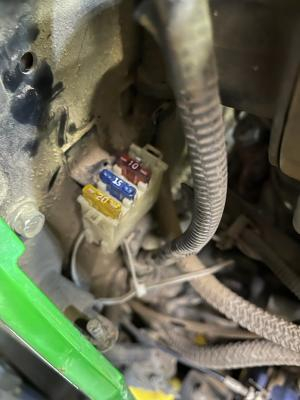

The PTO doesnt work and the furthest away fuse in the block keeps blowing. Im assuming its related to the PTO circuit. Like some info on what each of the four fuses in the block do and the proper amperage. Cant find any info anywhere! Here is a pic 0f the fuse box. Its the last slot missing the fuse. It has red/yellow wires in and out of the slot. Anybody know where it goes or a wiring diagram?

This might help
   / JOHN DEERE 2305 BLOWS 10 AMP FUSE #3
You might have lost the chassis ground, in which case another circuit is providing a backfeed, but the fuse protects that circuit. Run a jumper cable from the battery negative to the frame and see if that solves the problem. My YanDeere is notorious for this every 3 or 4 years.
   / JOHN DEERE 2305 BLOWS 10 AMP FUSE #4
So....does it blow when you turn on the PTO, and only when you turn on the PTO?
Im going to check today on exactly when the fuse blows during key on. start or when the pto is pulled.
Before I started anything I continuity check the fourth slot 10 amp fuse spades. One is a direct short to ground! It has a tan/red wire coming off the slot.

here is a pic of the fuse block. Its the 4th space missing the fuse. It is wired with red/yellow wires in that slot in and out. Can someone tell me or get a wiring diagram of where it goes? Cant find anything on the internet!
