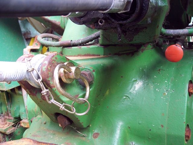

I noticed when I reviewed the photos that I had made an "incorrect statement" that I want to correct. The hyd oil check dipstick is in this photo you posted. It has the "red knob". I forgot later model tractors have the dipstick relocated from where earlier models were located.

Thanks Tx Jim, much appreciated. The hydraulic level on the dip stick is a the higher side of the two marks (as measured yesterday).

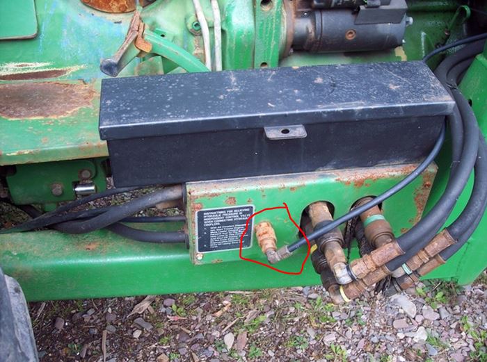

b&d
I'm trying to determine what the purpose is of the hose I circled in red. The parts schematic shows no such hose. Regen valve hoses are totally different from photo.

b&d
That hose is for a relief valve return to sump. You will find the relief valve on the inside of the right loader mast. The tractor end enters the transmission case at a fitting on the right side forward of your SCV. I'll bet you have mechanical self leveling loader. If your bucket is completely dumped or curled, raising or lower the boom would cause binding, the leveling feature trying to keep the bucket level.
I'll 2nd the 99% on smaller hyd pump. Thanks for explanation on extra hose. I guess I've never been around the self leveling bucket setup.
