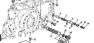

I can provide those part numbers from memory due to my 21+ yrs of employment at a JD dealership. Although 2440 has a serial number break @ sn 341,000 the filters are the same PN's. I would also suggest to check hyd oil sump screen(key 13) which requires draining of oil or placing nozzle of running shop vacuum in hyd filler hole with excess hole are blocked off with shop towel.
Hyd filter is AR75603,
engine oil filter is T19044
fuel filter is AR50041

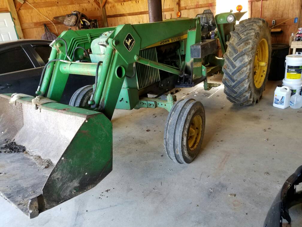

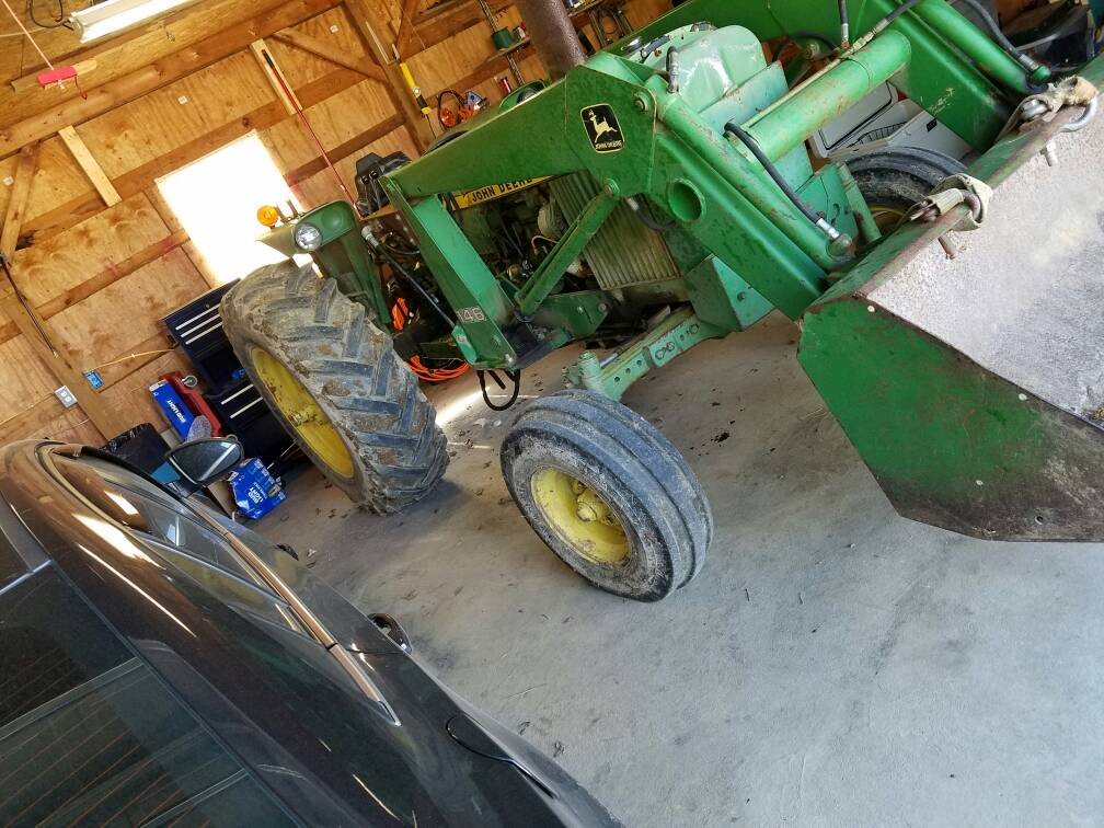

I'll attach some pictures of her. She's not a beauty but she works great for taking care of the horses. Slight remote leak and a FEL leak. A pretty decently hydro leak above the engine (pump?)
But so far she seems to fit the need well for the price. $5000 and a extra $300 fo 20170224_124109.jpg20170224_124100.jpgr bucket,both hay forks and a roto tiller.
Please give me input I want this tractor to last me a bit. I have everything but air filter to replace this weekend. 10 gallons of hydro and also engine oil and need coolant.
New guy with owning tractors but I seem to like this one and it's perfect for my needs.
   / John deere 2440 filters and maintenance #10
That looks like a nice solid tractor. Other than the nose piece on the hood, sheet metal looks straight and not rusted out. The 2440 was a real workhorse. You have the optional rack and pinion axles whichgives you more weight in the wheels. The 40 series utility tractors were being sold new when I started working For dealer in 1977. Set up quite a few of them and installed loaders. Your loader has 146 decals, but the lift cylinders appear to be from a 145. Can't tell on the bucket cylinders but they may be right for the 146. It will make a difference in the seal kits if that is what is leaking. You mentioned you didn't have air filters to install. TxJim didn't give you air filter numbers, so I can tell you primary filter is Ar84228 and secondary element is AE31724. It was nice back in those models. Filters interchanged over many models, now it seems every model takes a different filter and even some differences in serial number ranges or what tier emissions engine you have!?!
