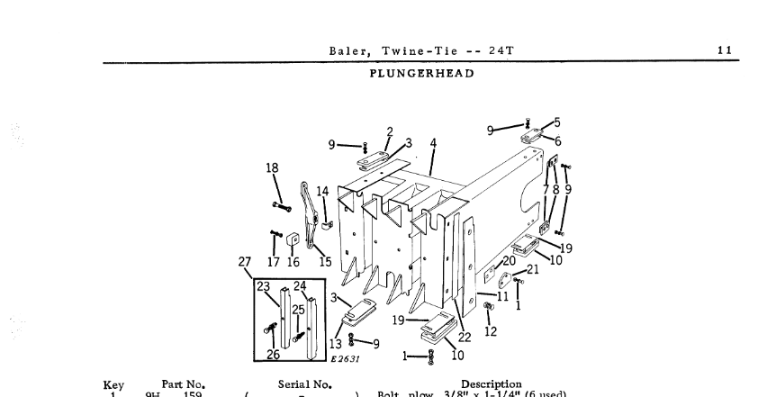

i live in new zealand, recently bought an australian assembled john deere 24 t baler sold new jan 1969 good order, apon inspection by removing small plate on top gearbox i find tooth galling on first input gears, certainly usable, is this often found? also plunger noisy and shudders when turning corners,i am a mechanic and drive line and drawbar set properly, have checked this, any thoughts ideas gratefully sought:)

I can't comment on gear galling. Is drawbar set at 14'' to center of hole from end of pto shaft? Since 24T was built before JD's introduction of the "equal angle hitch" or CV joints the pto driveline will tend to vibrate in sharp turns. Have you checked for excessive clearance between plunger head & PH guides?

JD 24T only has wear pads on PH but no brgs. I agree a SM is a good asset.

If I was going to use a JD 24T to bale hay I'd attach a short chain to the bridges(parts key 15) on PH so if attaching bolt(parts key 18) broke bridge would not get lost in hay field. I still remember selling bridges to farmers that lost them in the field and they were a lot cheaper back in the 60's-80's than today
E18887 Support - SUPPORT, ADD 186.34 USD
2 ea-E15459 Pad - PAD, ADD 55.23 USD
total 296.80
