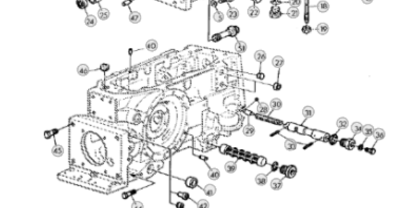

/ John Deere 2955 Hydraulic Issues Help! #19
Hyd filter relief valve that I recommended checking is keys 28-31 in photo below.
