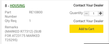

Ok its been a while since i have posted, i had a child so tractor had to wait, anyhow im back at it, im going to upgrade my open center steering to closed center, i removed the old steering valve today p/n T22829, which is correct for open center, however im looking to put a closed center valve on it, what part number will fit, and besides the pressure valve downstream from reversor what else do i need?
   / John deere 301a power steering pump #16
If your tractor has an open center pump then it's older than a 301A more like a model 300. CC PS valve housing casting #s are shown in photo below

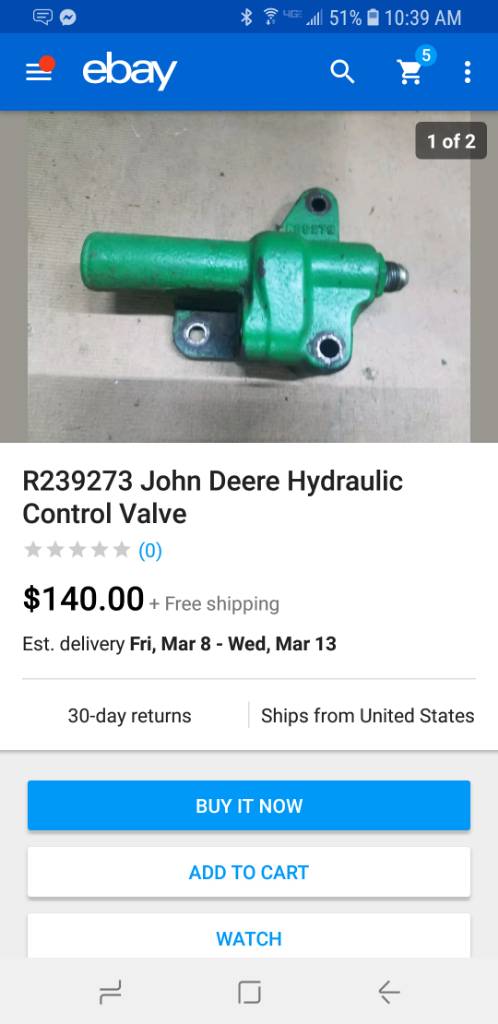

Also is this the correct control valve needed?Screenshot_20190227-103903_eBay.jpeg
   / John deere 301a power steering pump #18
photo you posted is of pressure control valve which gives priority hyd pressure so power steering will operate correctly when other hyd functions are utilized when power steering wheel is turned.
